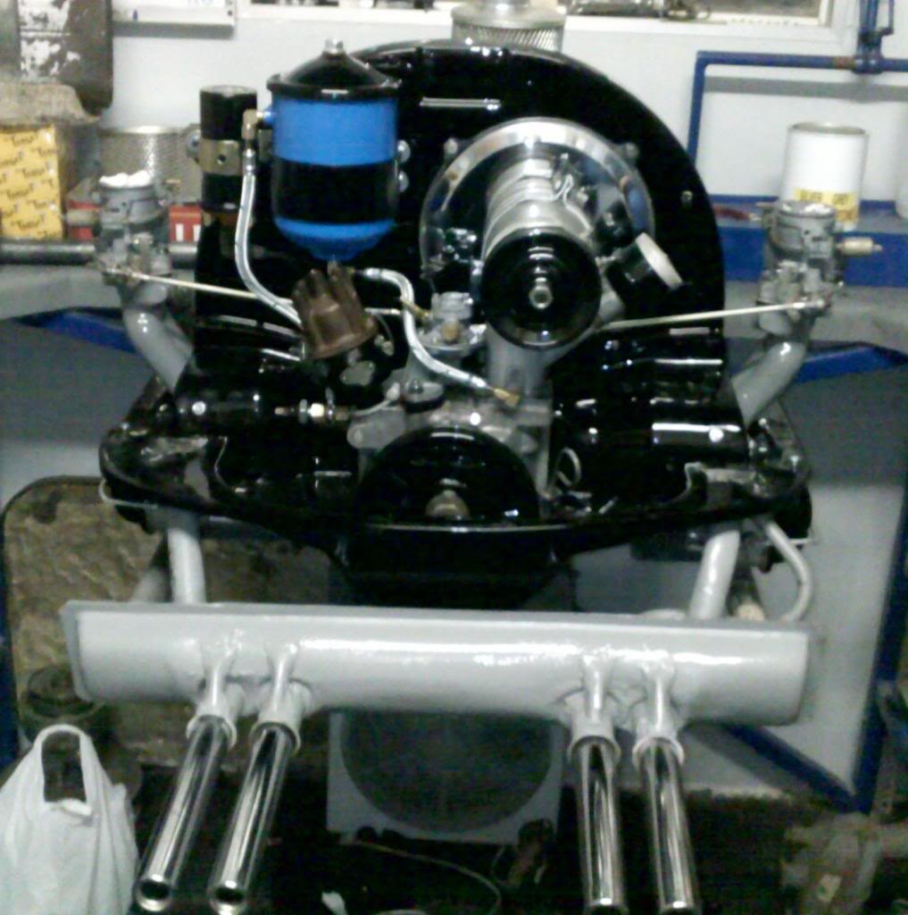

This weekend I started fitting my twin webers on my ghia.
I thought it would be a simple bolt on affair. As you can see the carbs push up against the fan shroud
and therefore I need to modify the shroud or get a new one (luckily I've got a spare to modify)
Any other ideas folks?

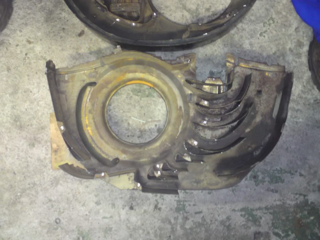

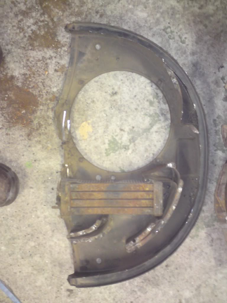

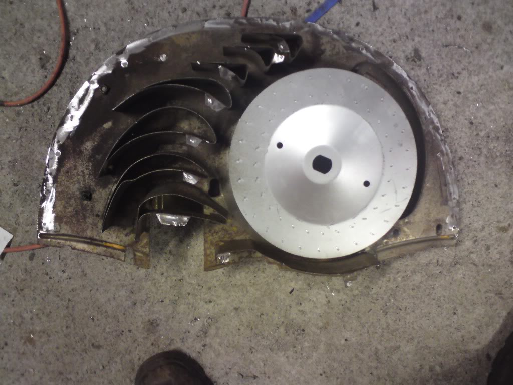

Had the same problem and made a hybrid fanhousing with an early d housing coupled with a late doghouse.
Armand
Re: Twin Webers
On the 1776 with twin Weber IDFs that IMPI built for me last year, he uased a 36hp fan shroud, which doesn't snag the carbs, but he first gutted it and welded in all the bits from a doghouse fan shroud.
I thought this was a much more stylish solution than removing the heater outlets and cutting notches into the later fan shroud.

Those intakes look like they are meant for the reproduction EMPI 36hp shroud or the silly angled chrome shroud without the internal oil cooler.
Any chance you can get taller intakes meant for the stock shroud? Or are you guys kinda stuck without many options?
Something like item 3169 on this page, these are modern repros of classic Dell'Orto intakes:
http://www.cbperformance.com/catalog.asp?ProductID=532
I don't know it all, just enough to be dangerous!

Class 11 streeter wrote:Those intakes look like they are meant for the reproduction EMPI 36hp shroud or the silly angled chrome shroud without the internal oil cooler.
I am limited by the sprung hinges on the engine lid, so can't go any higher
