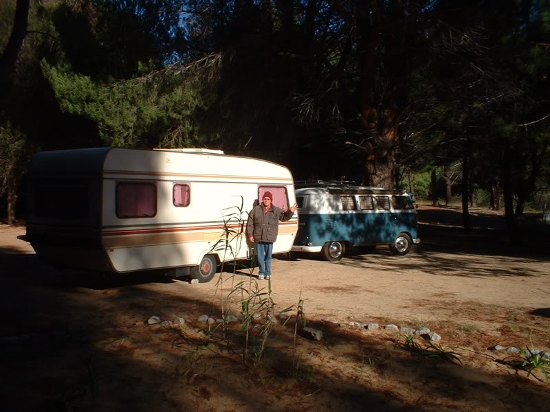

Your caravan is more aerodynamically- efficient than most local ones. Do a test run and see how it does.

Some Inspiration for you Jacques.... even though its an Eriba Puck!
Only other thing that I can think of is braking. Great if your trailer has brakes, especially down hills and around sweeping downhill bends. Otherwise attemp it at slow speeds with caution.

this guy does it.....but i don't know what's under the hood !
