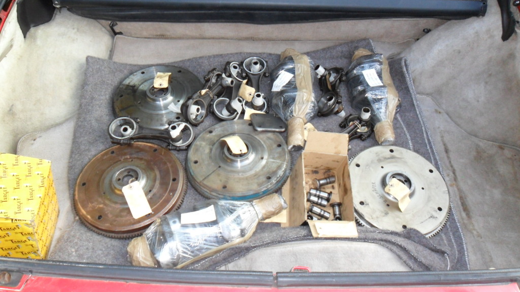

Hi I now own a 16 conrod porsche.
Had to go fetch a few parts from my machinist today Who says Porsches are not practical
Enjoy
Armand

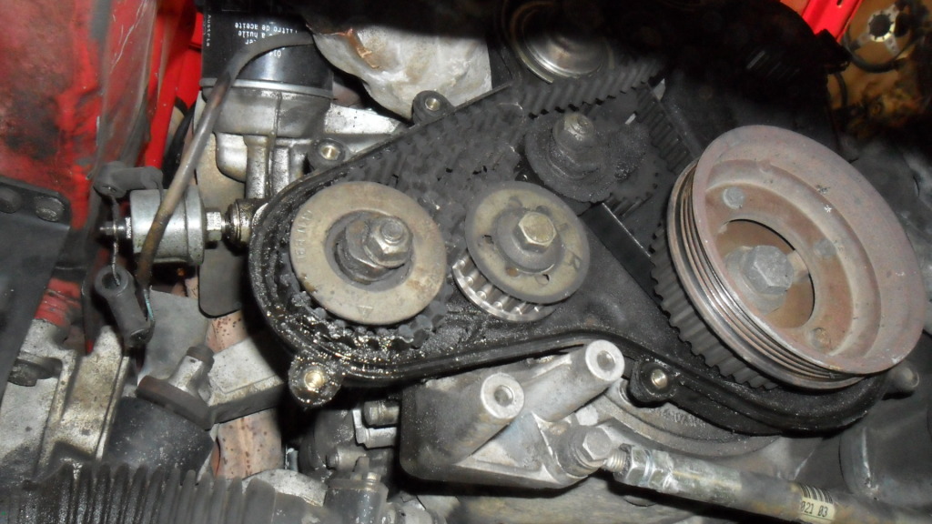

Have been planning a major service since I bought the car and magically a year has passed before I got to it
The car has had some vibration since I have had it and a strange rattle from the bottom of the car.
The rattle turned out to be an improperly fitted silencer fixed that and it was better
Horror stories on the net warned about timing belts and this was on the list as well as idlers etc
I found the cause of the vibration the balance shaft belt was broken and has been for as long as I own the car (lots of racers remove the balance shafts with no il reported effects.

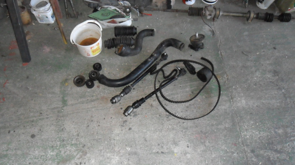

the parts I replaced
The tie rods were swopped for golf 2 parts which fitted surprisingly easy

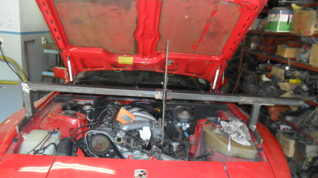

I also had to make an engine support to be able to remove the engine mounts which turned out to be broken.
the headlight motor also took this time to pack up and I now drive with the headlights up all the time
Hope porsche guy or someone has a spare
Armand
