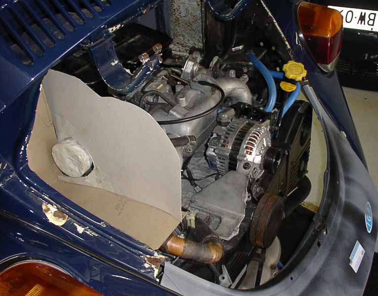

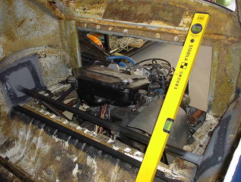

Read this. The guy's in Auz are quite jacked up with scoobie engines:
http://forums.aussieveedubbers.com/view ... ?tid=88099
http://www.shoptalkforums.com/viewtopic ... 19&t=33199
Some serious cutting required
Also a gearbox to handle all that torqe. Why not build a reliable 1600 or speak to IMPI for a upright type 4? much cheaper and no need for radiators and cutting

Stay with the Subaru idea, yes, it costs more money for the parts, yes, it's complicated to install in a bug but with the Subi conversion you don't have that ugly looking decklid that makes it look as if you've got a fridge in the back of your car.
I plan on getting a Subi motor in the back of my ride as soon as I've resprayed it and fixed up my interior, the golf engine is cheaper to install but it robs your car of that beautiful vintage shape. I'd rather have a weak well maintained 1600cc engine in the back rather than a powerful fridge. From what I've heard, the Subaru SOHC engine doesn't require any cutting in the engine bay and the DOHC and Turbo derivatives are the ones which require a lot of cutting.
The ball is in your court but I'd recommend the heart of a Scoobie.
