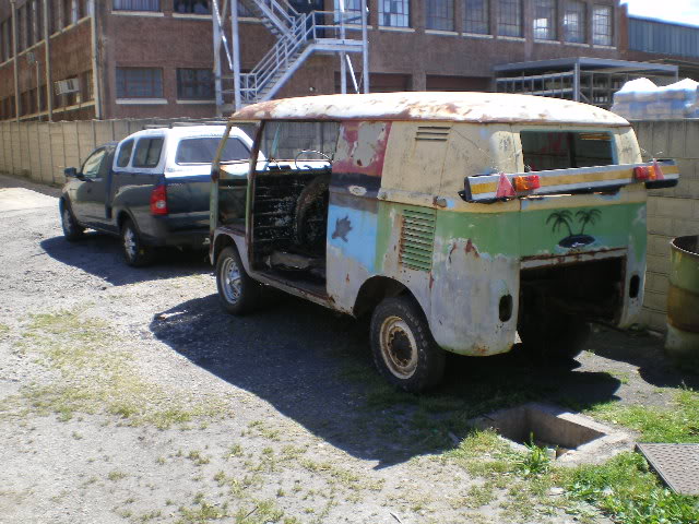

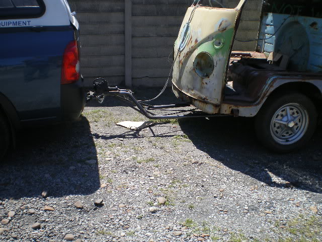

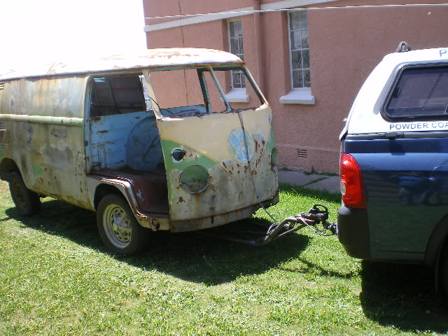

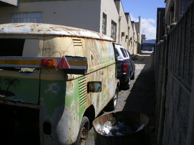

Just to refresh your memory, here are the pic's again of the bus, going to the workshop.

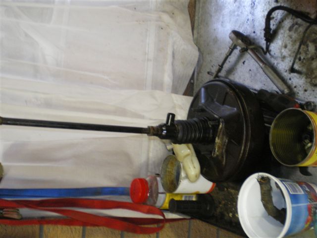

So I have started to get the parts together for this project.
Had some green panels ordered for the body work.
Awaiting the Lights and tail lights from Bugger possibly.

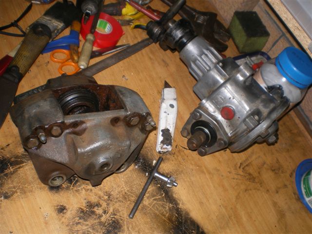

The new steering box is also in hand.

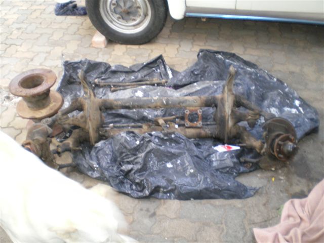

Got me a new beam (well its an old one that needs renewal.)
With the master cylinder and disk brake calipers.
The booster is also there.
Sorry they still look tacky, but will be renewing them as I go along.
Got a wide set of wheels, which I have welded up and is going to the powder coaters, with the Rostyles that I got from HR.
Had two of them widened to 6J as well, sorry no pic's, these will follow.
