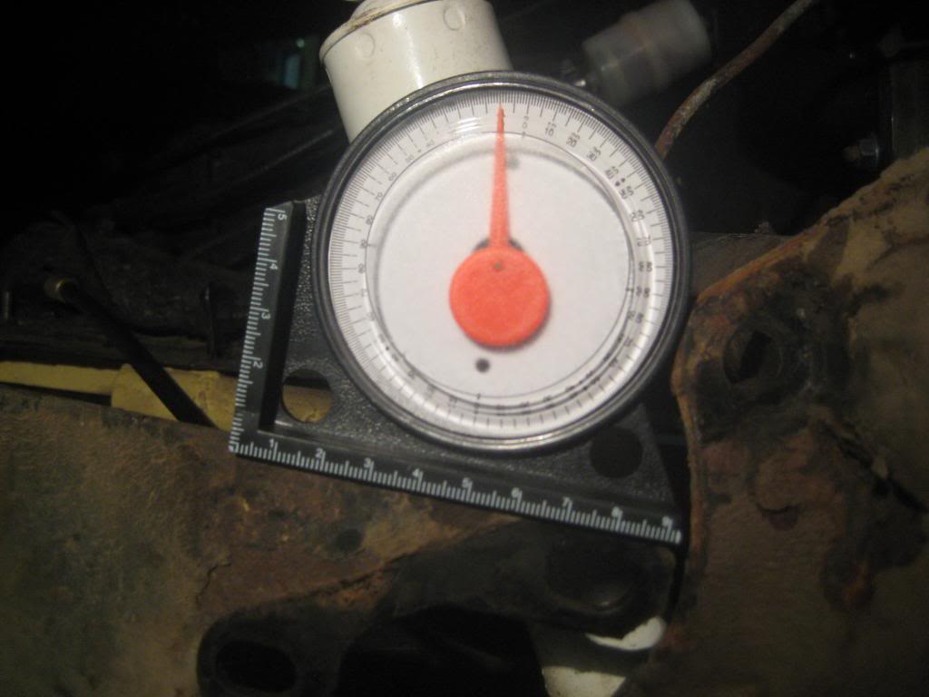

The main issue that I had with the suspension, was that it always felt softer on the one side (left) than on the other. I started on the left hand side, and used a trolley jack to lift the spring plate over the stop. To be honest, I was sh1tscared that the springplate was going to come flying off, luckily nothing of the sort happened. With the springplate (and me...) now in a relaxed state, I measured the angle, and got +/- 10 degrees.

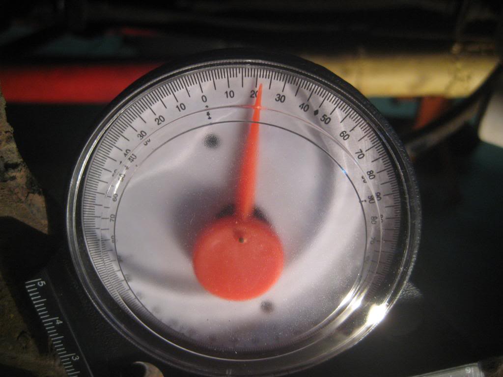

Started stripping the right hand side, this time the springplate needed a bit more persuasion to clear the stop. Measuring the angle, I got +/- 22 degrees!

The spring plate angle at the moment is about 21*, and it seems as if it might a bit too much, stock being around 17*. Wheels have a lot of positive camber at the moment.
We had to play around with the settings on the one side to get both to the same angle, now it seems that I might have to lower both sides by one spline on the outside, which will bring it to about 13*, hopefully.

OK so the job is done.
I was happy. I cannot tell about Loopy as his facial expression never changes whether he's or
He seemed happy. We also called in some expert advice to assist with the spring plates. Now they are both set at 16 degrees and the buggy is level.
