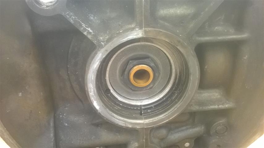

My ball joints were in dire need of replacement as were my wheel bearings. So, I got hold of a proper set of German ball joints and went about fitting them. Lets just say that this isnt a job for the faint hearted and not having a press leads to things being rather entertaining.
The bearings were simple, old out, go to SKF, get new bearings and seals, put new in, incl races.
As for the ball joints, well this took a lot more time than I thought.
As can be seen below, the boots were shot and they had lived for quite a while with the torn boots.
As per the manual, if dirt gets past the boots into the socket, then you need new balljoints. Why? Well, the joint itself is supported by a special type of plastic or nylon. So, if sand gets in, then it tears up the plastic socket.
The old balljoints still had the VW stamp on them, so its possible that they were the originals.

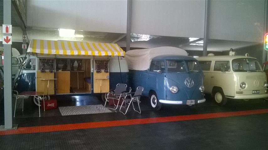

I didnt take enough pics of the autovilla campout, but here are a few from the weekend.

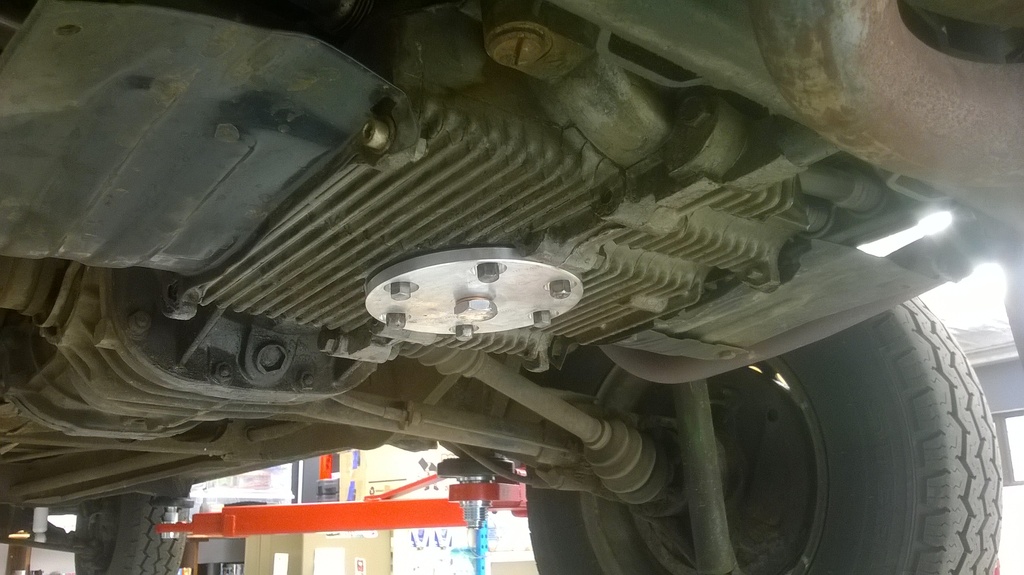

Not entirely too much happened on the project front, with most work happening to the bus and a little driving of Angrrr.
As this is the bus thread, I'll mention what I did to the bus
First off was to replace the partquip balljoint which I needed to install a while back. My own stupidity lead to me installing one of my imported balljoints "off center". So yea, I had to cut out the new one and install a partquip cheapy.
Now I imported a few new units again and replaced the cheapy with a proper unit.
I also imported two new tie rods and a new drag link from Brazil via USA. These are all now fitted and the steering is great - not much better than it was, but this goes to show how good the old parts were still.
I then got a free wheel alignment from TSW in Durbanville as I had to teach their training guy (its a new shop and the guys are still in training) how to align a bus's front end. Also, I took all the tools I needed and we needed to use them.
Before wheel alignment, I noticed that the EMPI twin silencer system was falling apart with the one silencer ready to drop off. So I removed it and fitted another EMPI silencer I had lying around.
Also, I decided that its time to to another service. Oil out... adjusted tappets (only 1 or 2 needed adjusting and not by much).
I then took a look at the old warped sump plate and decided to make something new.
I didnt take photos of all the steps, but here are 3
It is a bit thick, so next time it comes off I'll take 1mm off it.

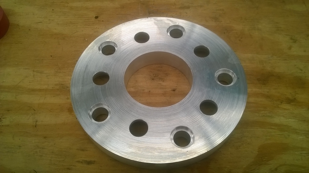

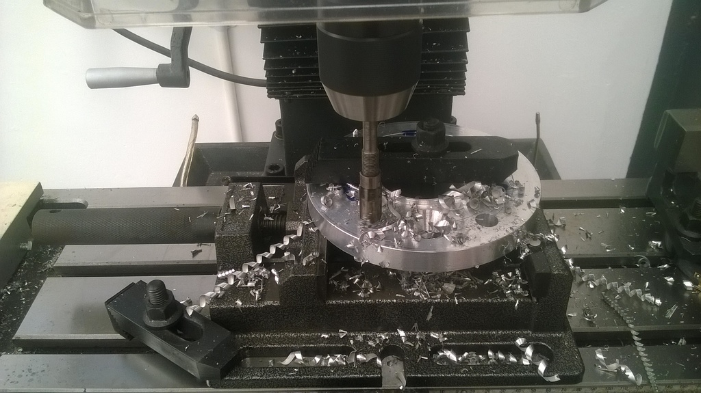

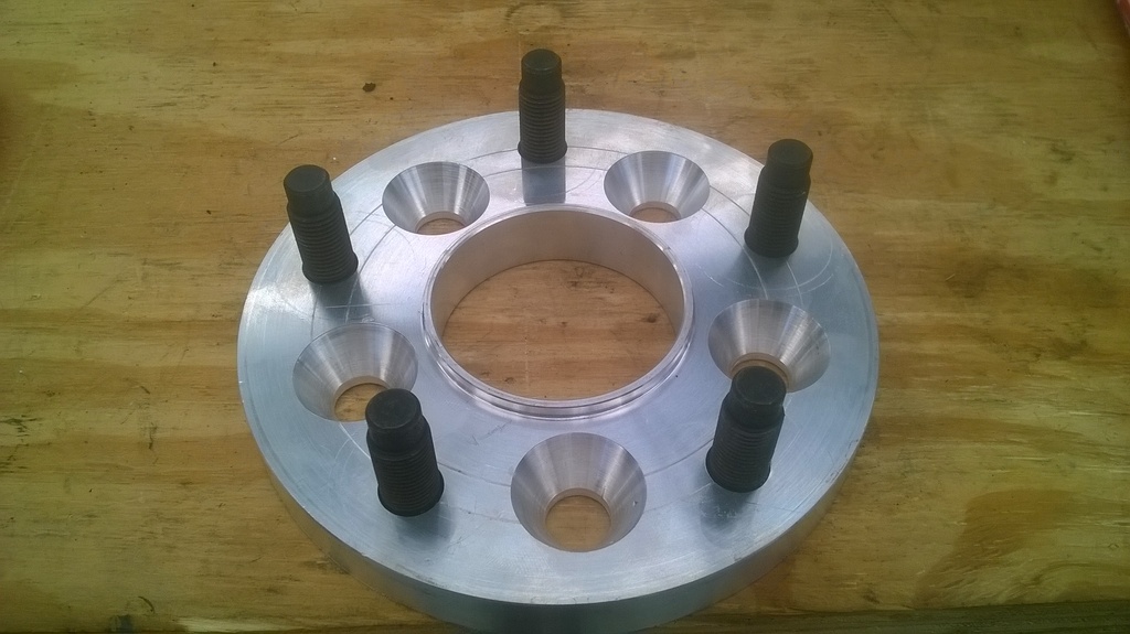

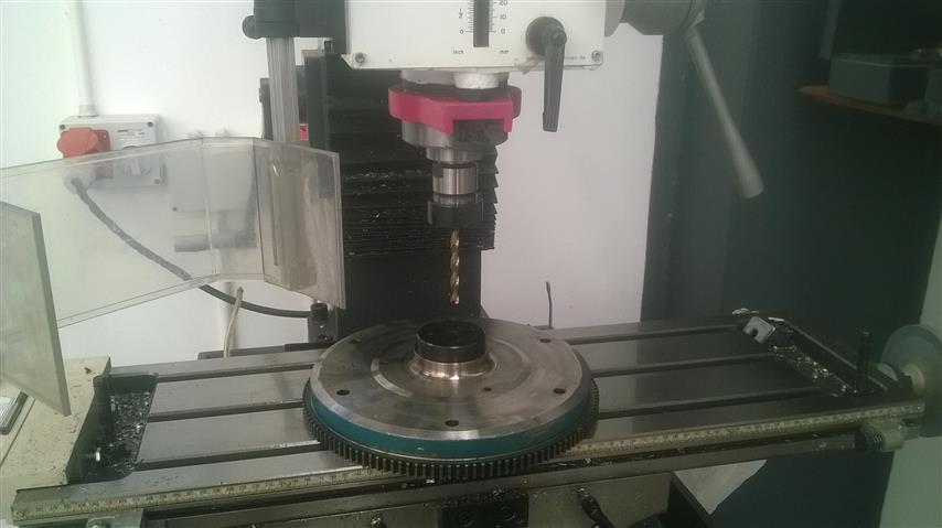

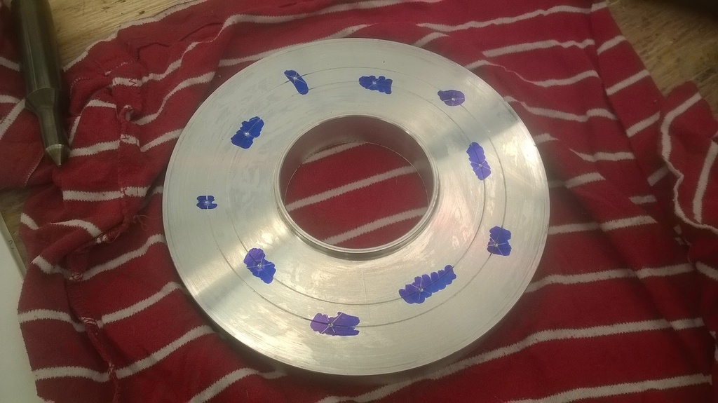

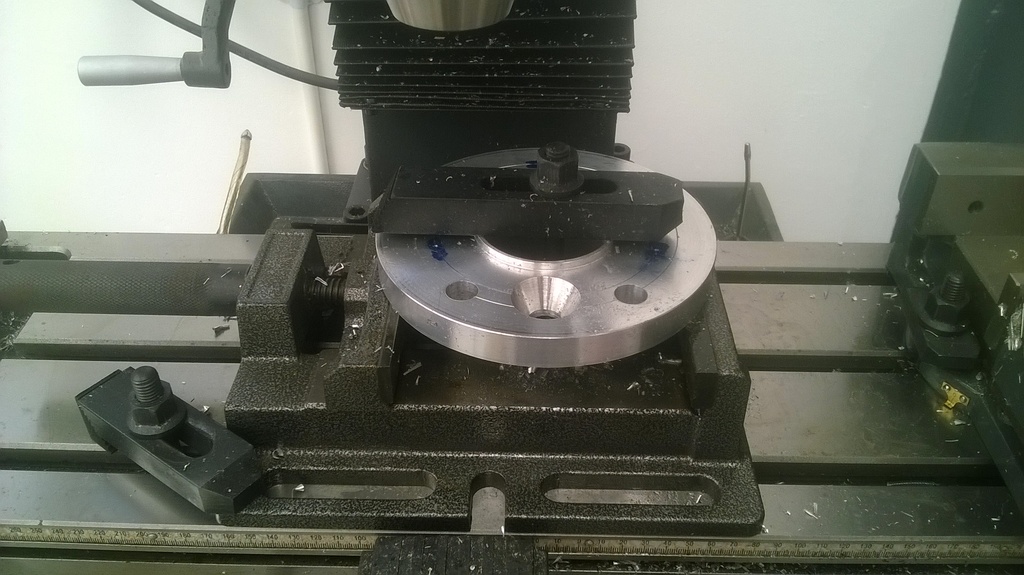

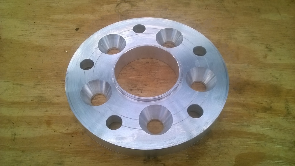

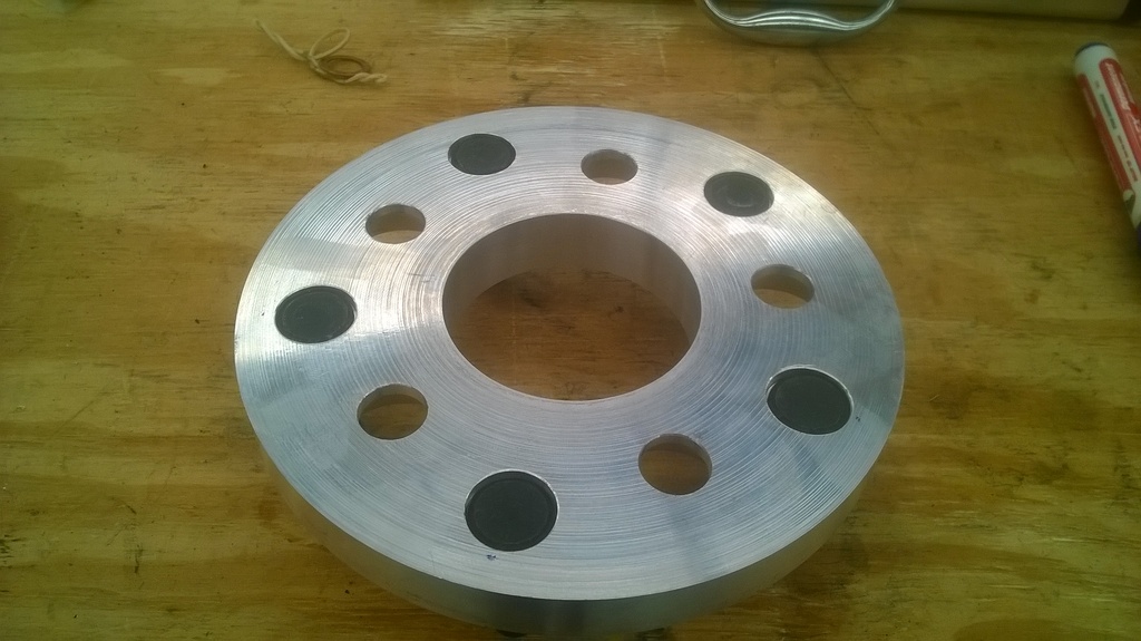

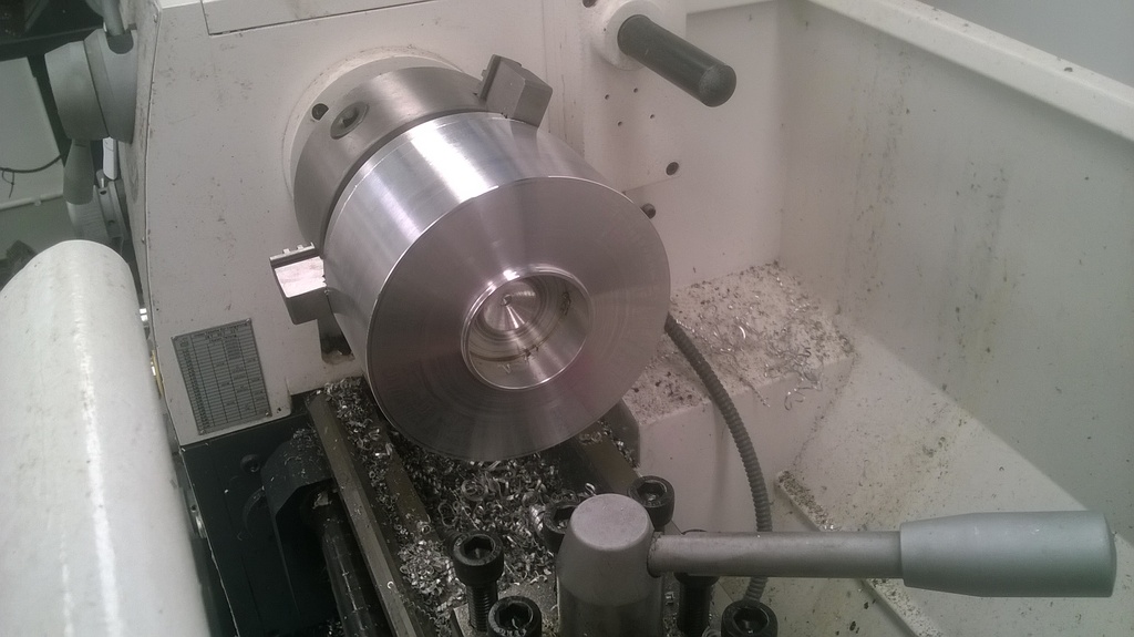

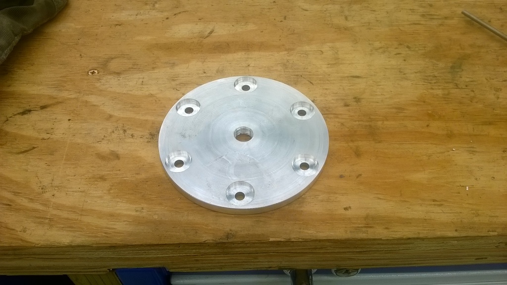

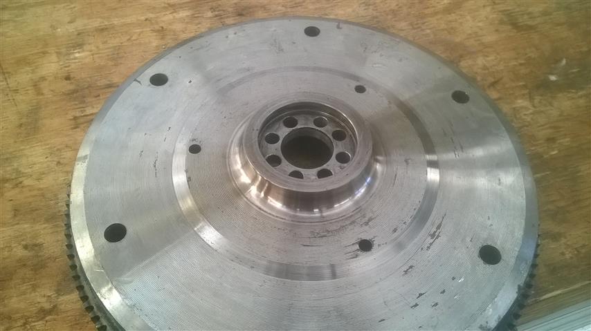

And then as a side project, I decided to try something.

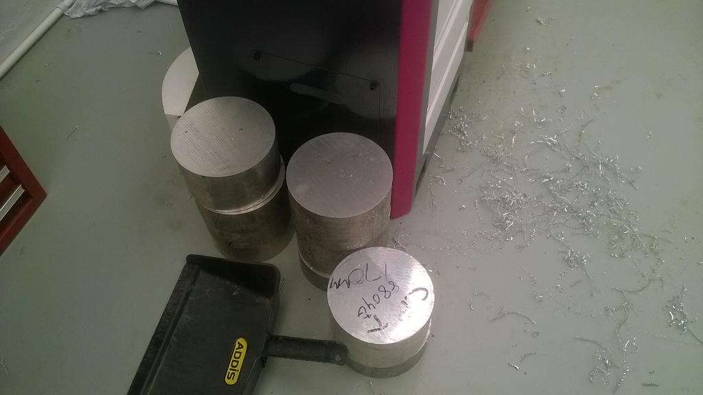

Take some aluminium billet
stick it into a lathe

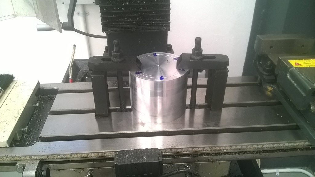

turn it into something nice and mark it out
continue making it into something - note the use of an good quality adjustable reamer for exact sizing
Near final result
final result

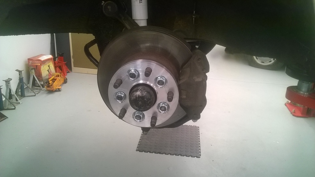

And then I took it off and fitted the stock wheel again.
Now I have active working measurements to make up my own adapters for when I get to an upcoming project.
For now though, the bus is still the same as it was before
Near final result
final result

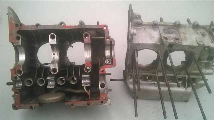

OK, I think its about time I do an update, now that I have something to update.
Not many of you know this, but I have been unemployed now for going on 10 months. Its a bit of an unfortunate situation with new regulations coming into play which have basically made me unqualified for the position I held for the last 8 years. So I have been in and out of the UK doing conversion courses and exams. Hopefully this is coming to an end now after my next trip to UK. All going well, I'll be able to look for work again soon.
How does this relate to the bus??? Well, since money doesnt last forever, I decided that its time to sell the 1700 engine and put together another one that I have been planning for a while now. OK, the spec wasnt 100% what I originally planned, but as funds are tight, I kept things cheap and used what I had already.
So yea, 1700 engine out and sold. I will really miss this engine, this was/is a true gem of an engine. And awesome replacement for the 1600 bus engine with a bit of extra power and eager to run.

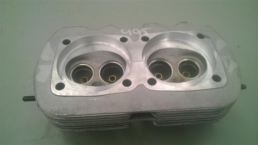

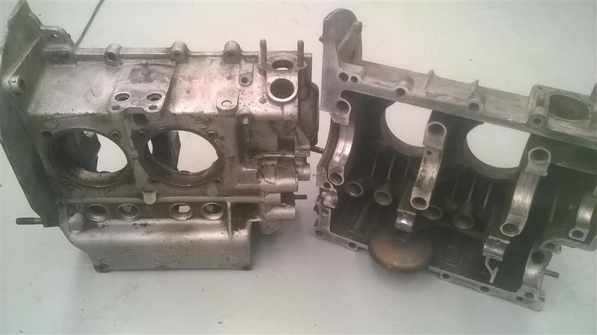

Once again, I have decided to go against the grain with the new engine build. All the guys who I spoke to said I was wasting my time and the engine wouldnt work as a combo. Blah blah blah, those same guys told me the same things about the 1700 engine...
So the specs for the new engine?
2110 cc
82mm stroker crank
90.5mm stroker pistons
Scat H-beam con rods 5.325" (Short rods)
Engle 110 cam and lifters
single HD valve springs
New 1600 heads with stock valve sizes

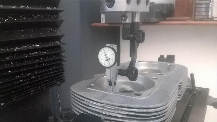

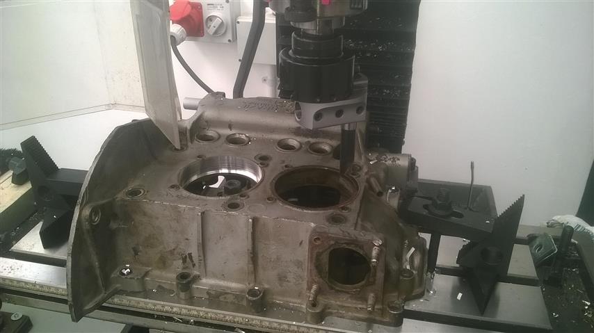

The build begins with some work to open the case and heads up for the larger 90.5mm piston kit
Take case and give it a preliminary wash
strip case so it fits on the mill
put case on mill
clock up and cut case
put heads on mill and clock up
cut heads for 90.5mm cylinders
[/quote]

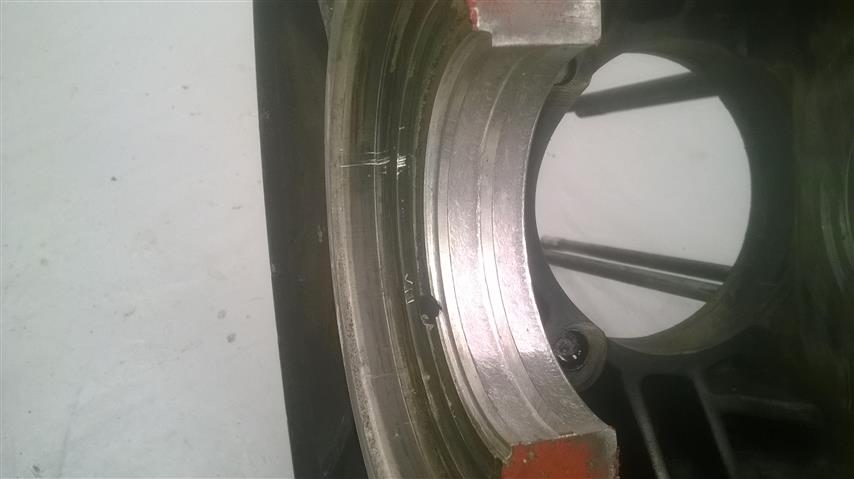

then when doing a few smaller touches I noticed that the thrust face looks a bit more worn than I first thought...
turns out it is already past its minimum size of 20mm. It measures 19.8mm already.
After re-cutting the thrust face, I went to a local spares shop and bought a set of oversized 1100 golf rings (20 thou over I think it was). This worked out as a brilliant spacer.
Install it with the gap vertically up
put case on mill
[/quote]

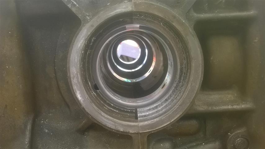

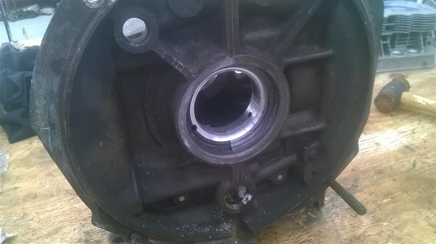

Put all the case bolts back in excluding the head studs.
Then bolted the case together and torqued it down.

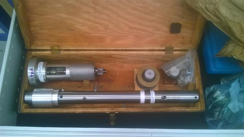

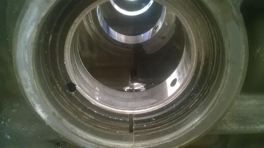

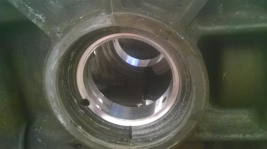

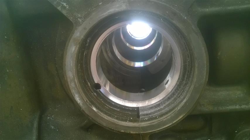

Out with my line bore tools
The case is cut for standard mains, but I can see the #1 (thrust) bearing will need more than a 0,5mm cut.
But instead of moving straight to a 1mm cut, I went for the 0.5mm cut first so that I have a good seating point to cut the thrust face.
I am not fond of the way the thrust cutter marks the journal, so it should to be done before the line bore. Anyway, my logic was to give it a bigger, rounder seating area by boring to 0.5mm then doing the thrust cut and then reboring to 1mm which should be final size.
0.5mm line bore
Thrust block inserted and cutting of the thrust face
You might notice that the thrust face isnt 100% cleaned up. That is due to the amount of wear of the face. I cant cut it further as I have no secure way of locating the thrust cutter and keeping it level if it doesnt rest against the case from the inside. But it does cut a larger diameter than the previous cut, so it is still nicely cleaned up enough to support the bearing.
1mm cut - unfortunately, this still didnt clean up the bearing journal
So, on to a 1.5mm cut. This cleaned it up nicely.
Here is a picture of the thrust bearing spacer (piston ring) which I used
Thanks to the local spares shops not having the bearing size that I needed, I had to order a set of bearings from USA. Taking Murpheys law into account, I ordered two sets.
When they finally arrived, I cut the first one to fit the thrust bearing and spacer. I wasnt happy with this job as I cut it 0.02mm too wide and this would allow the spacer to turn slightly once the engine was bolted together. So I cut the second thrust bearing a tiny bit less and this one fits properly.
0.5mm line bore

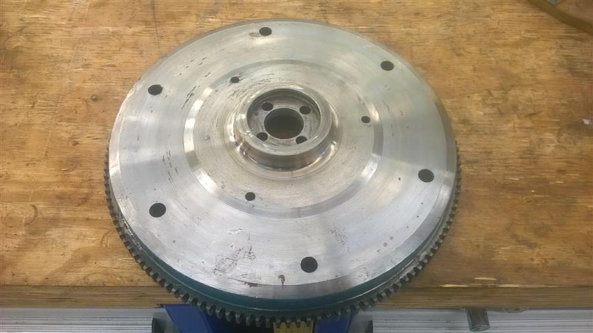

For now, we are onto 8-doweling of the flywheel
Take a normal flywheel in good condition
Put it in the milling machine, clamp it down and drill it out for another 4 dowel pins. This helps in keeping it in place when the engine is capable of producing a bit more hp.
Final result
As the new holes are made to an exact size, it is best to do a pilot hole and then ream the hole to the correct size needed.
And to ensure that the drill and reamer run properly true, dont even consider using a drill chuck. This is where you pull out the collet set to ensure that it all runs properly true.
Being that it is going into a bus, the flywheel wasnt lightened. If this engine was headed into a beetle, I definitely would have taken some weight off the flywheel...
Final result

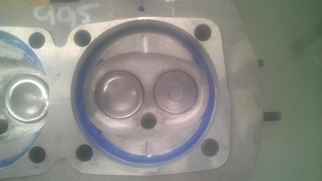

My original plan with the heads was to mimic to 80's ralley cars with 38mm inlet valves and 32mm exhaust valves. I took the heads to Andreno to have my 38mm seats installed and he pointed out that there isnt enough meat between the spark plug hole and the seat to do this safely. So to do this correctly, the heads need to be welded and the spark plug hole recut, and then all the seats need to be installed again. Once again, I was told that I am wrong with my valve sizes and that this engine nees 42mm inlet and 38mm exhaust valves. His price to do my heads as I wanted them was R4000. So I declined. I just cant spend that kind of money at the moment, especially not for a tiny increase in valve size.
My reason for keeping the valve sizes small is once again because this is going into a bus. If it were for a beetle, then I'd aim for more power and the bigger valves will help achieve this. But since this engine is for a bus, my intention was to keep the intake air flow speed high, which increases drivability and power delivery. OK, it does limit ultimate power, but up to the point where the ports and vlaves become the limit, there is more torque produced and it is easier to drive.
So my aim is big engine with small, high speed ports. All with the aim of making it easier to drive.
I am using stock valves with a bit of porting. I didnt spend too much time on the ports, but I did spend a lot of time on the seats and chambers.
I also cut in a set of Singh grooves. Different layout to what I did for Wentzel, but I think this will work fine for me.
Chambers
Springs, retainers and collets
Valve shims

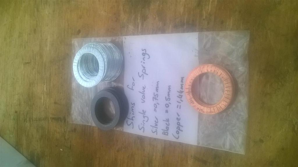

I set the valves up so that they have 3mm more compression available before they coil bind.
Now a rant.
Back in about 2002 I bought a set of new Autolinea G01 heads. These heads were fantastic.
So, last year I bought another set. Be warned, the new G01 castings are truely crap.
All 4 combustion chambers are different out of the box, with a 4cc difference from largest to smallest.
The seats are all installed at different heights, even on the same head. And its not like intakes are at 1 height and exhausts at a different - they are all different.
Its just piss poor quality.
Maybe next time I should try a set of Chinese heads - they cant be much worse than these.
The seats were treated to a good 3 angle grind and the valves were all backcut to improve air flow.
I also shortened the guides by about 15mm each. This time with the aim of getting more air through the ports to increase power.
Cutting the guides back a little can increase the valve temperature as a fair amount of the heat in the valve is absorbed by the guide. But.... I had my valves all ceramic coated, so there is a fair bit less heat going into the valves anyway.
Using the Engle 110 cam, the recommended compression ratio is between 8:1 and 8.5:1.
Small ports, limited total power and smallish carbs - so I decided on 9:1 compression. Time will tell if this was a good call or not
Chambers
Valve shims
Now a rant.
