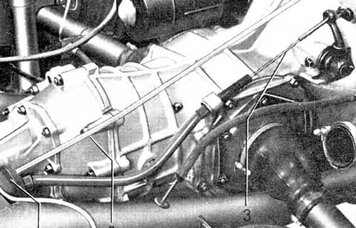

Did you remember to bend the Bowden Tube to about 25 mm, It must NOT be strait.??JohanSmith wrote:Hi guys
I am having the exact same thing after replacing my clutch cable today. I replaced everything the same way it came out, but the shudder stays horrible. Please help.
Cheers
Johan
See 1st photo above, you will see how it must be bent, then also check your engine mounting as well as your gearbox mountings.
