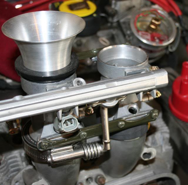

There was a guy on the ShopTalkForums who used a 45mm system from a ZX12-R on his Type 4 motor, am planning to do the same mod on my Type4 engine if the budget allows..
Let me see if I can get some pics...

Well a bit more research has provided me with a fuel rail set-up and injectors from a 160i Honda for R200-00. I'm going to be cutting the fuel rail into two and threading the one side for the fuel pipes.
Now........600cc motorbike ITB's are actually a bit too small for my 2.0 set-up. They are usually 36-38mm, so I've decided to go bigger. Ideally I'm going to be looking for a set of 45mm ITB's and I have a lead on a a Kawazaki ZXR Ninja 1400. I'm told they have 42-45mm tb's, so who knows.

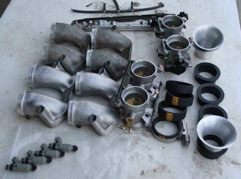

I was thinking the same until someone on the speedster owners club said that 38mm tb's would be unsuitable for my set-up.
I've still kept the 3 sets that I picked up and upon testing the TPS and map sensor on each tonight, I'll decide which one that I'll take, at the end of the day they're only costing me R800.
You'd be surprised how availible these sets of ITB's are........I found 4 sets within 1 scrapyard 10 minutes from my house.

GSX-R750 throttle bodies are 45mm
Guys use these on their cars as well, better than paying R7000 for Jenveys!!!There's a guy on the Gotech forum that has those 45mm t-bodies on his Ford Escort, check it out...
