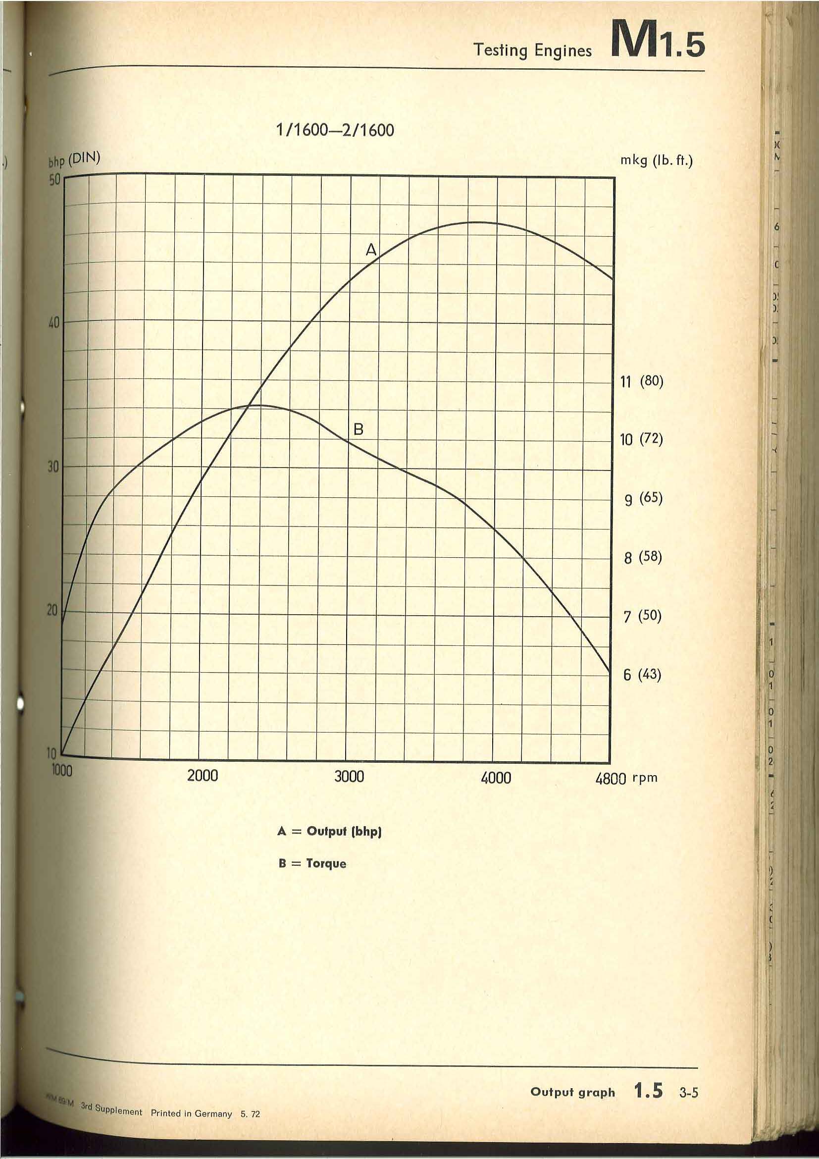

Twin port produces more power and torque right across the rev range. I've posted the graphs here before; I'll see if I can find them again.

Single port 1600:
Twin port 1600
Be careful when comparing the above graphs, the torque scales differ.
