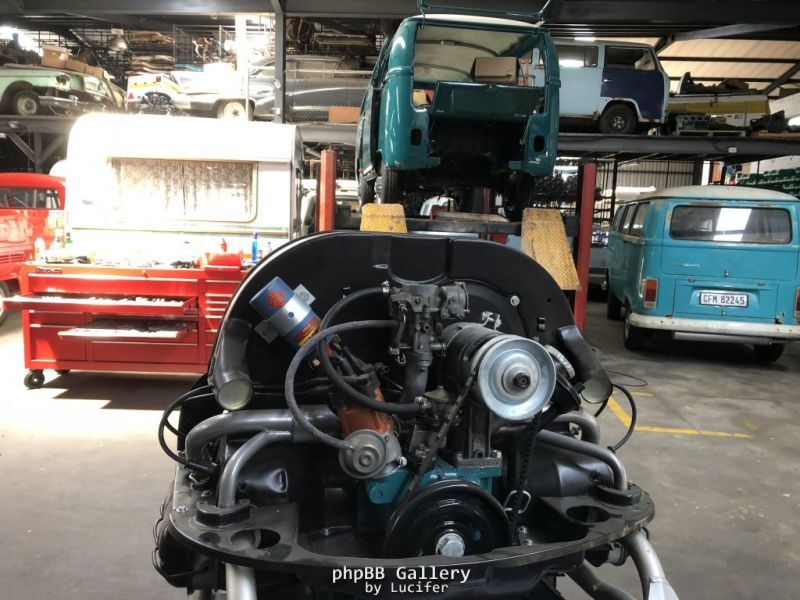

Last weekend I started on the mechanical components. The gearbox I simply cleaned up on the outside. The motor is a freshly rebuild 1600 single port with generator.
Being on my own, I was lazy to remove that engine off the table, so I rather just put the engine and gearbox in the bus in one shot on the table and under the lift. It worked pretty well actually and I didnt have to pick up anything heavy. :)
More to follow later.

Did you just use a jet wash for the outside of the gearbox ?

No, it was quite a hideous long process of using a wire brush on a pencil grinder to clean it up. I think it swallowed 3 of those brush wheels in the process.
