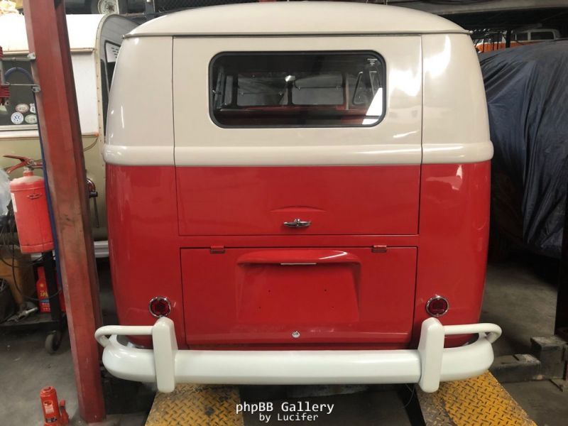

Testing 2 rear doors and rear bumper for alignment. They don't line up perfectly at the moment, but ill keep struggling away to get it lined up.

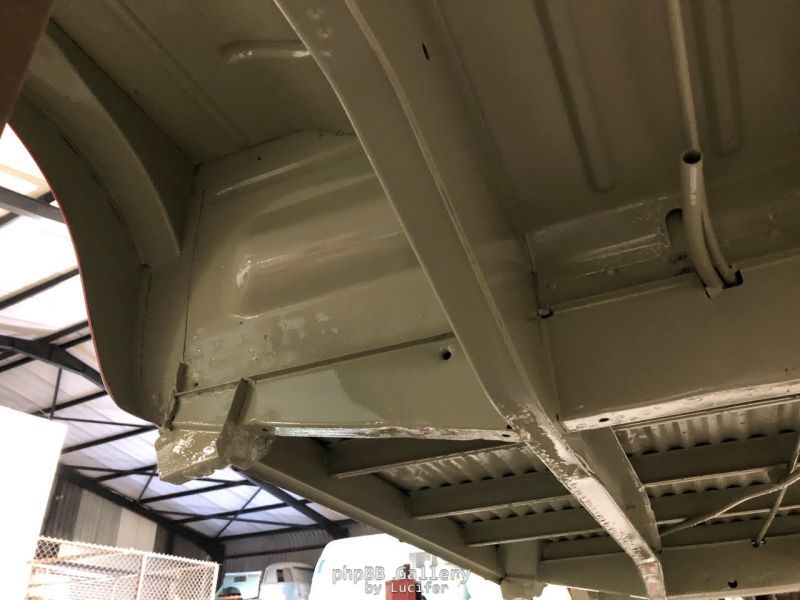

And some more pics of the underside.
I had to take the gearbox out again as I had a leak on the one reduction gear and another leak on the nose cone. Most irritating to take it out again but best do it now before oil contaminates the outside. Hopefully I should be done with the mechanicals this weekend and it will be good to hit the road.
