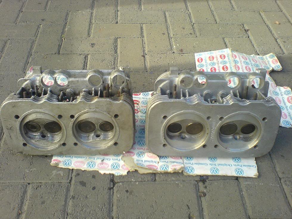

Since the heads on the vanagon is in a bad state, I,ve bought 2 x 1800 heads
The one has never been used (still in the parts box) the other is reconditioned. 39mm inlets

Those heads are they square port or oval ports
If you are going to take out the valve seats from a new set of VW heads Im sure that You can talk to Armant and he could make a deal with you for a BRAND NEW HEAD for a GOOD 2nd one to TURTURE and remove the valve seats for bigger ones
It will just be a pitty to see a new head go (Under stand my point here) for a waste

Where the hell did you find a new Type 4 head
I passed up a set of good Squareport heads at a swopmeet (Stupid me), and after crying on the forum about it, another forum member offered me a set of heads that he has in storage As soon as I get them my engine build can also start...

Blitz - the head was in a guy's shop here for a VERY long time (he kept it for the airplane guys for many years) until I recognized it in the shop front window. It's the oval exhaust port tipe (I didn't know it's anything special) I must add that I paid R900,00 for it. Don't know if that's too much.
The refurbished head I got from a scrapyard. It's a disappointment not to get the 41mm inlet valve type, but there was none to be found (checked about 14 heads). You guys will cry when you hear this - at this scrapyard there were about 4 split front window busses - totally rusted up and about 12 other busses (year after the split) all rusting away after what looks like a veld fire and all the rain. I also saw type 3 and 2 type 4 variants.
Wish I was a millionaire to buy them all.
