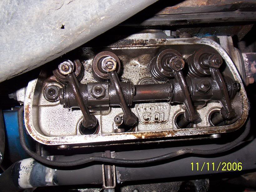

Although, it was put back, the tappet noise was still there. We had a guy who tried to adjust the tappets, but he said that he could with on of them as it was at it's maximum. He adjusted the timing, but ever since he left, the beetle seems to be firing on all of one cylinder.
- Posts: 15008
Re: Okay...So the engine's out

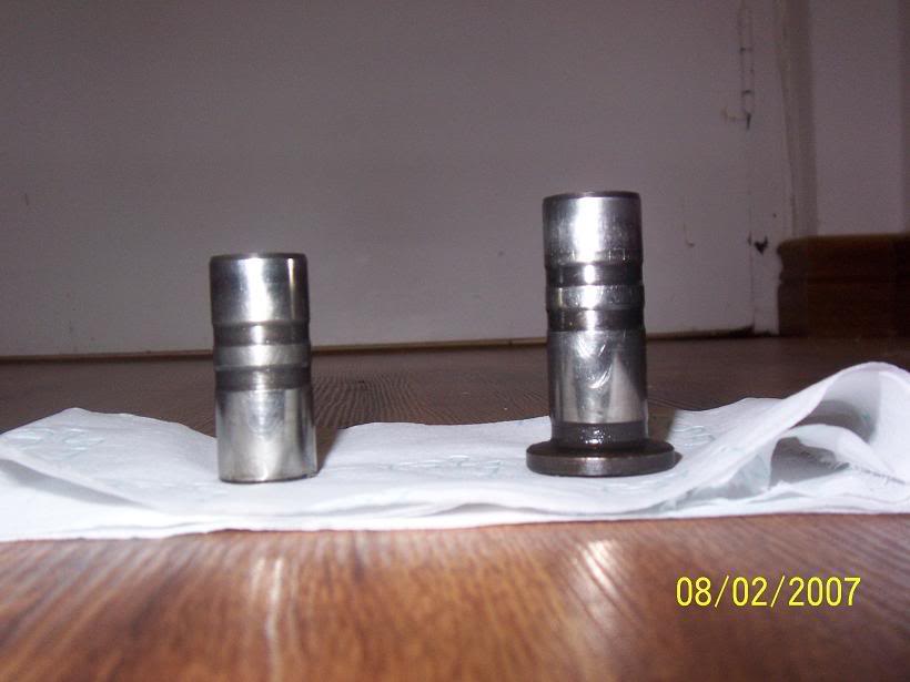

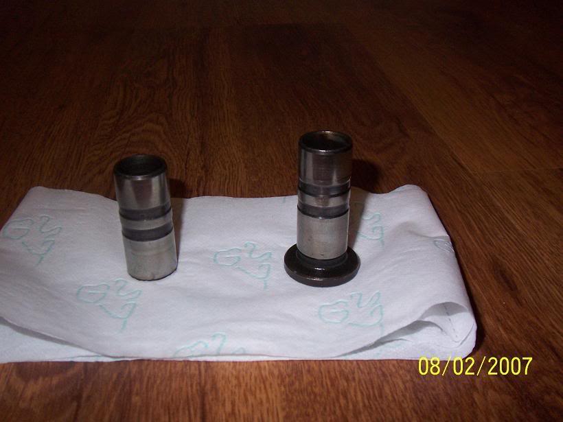

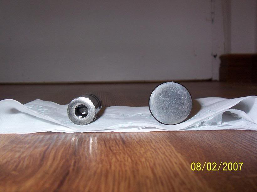

if there is one tappet that is beyond adjustment, remove the rockers and check the pushrod. If the pushrod is OK, check the rocker and adjuster, you might be lucky to find them worn badly (highly unlikely). You prob have a broken cam follower and need to tear the engine down completely. Happened to me once on a very steep cam profile, I'll try to find a pic so you can see what I mean....
- Posts: 15008
OK, for me, everytime I adjusted the valves, I couldnt get one of them right. I even put in my Porsche adjuster to provide extra length but that also didnt help. Everytime I drove the car, one of the pushrods would pop out. Ended up having to do a complete rebuilb....
Good cam follower has the flat part on it....
