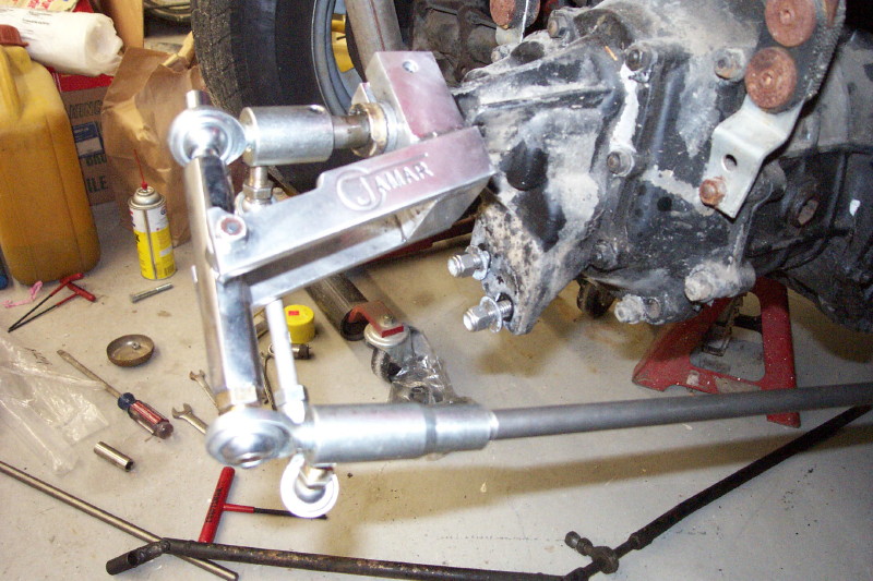

If I may ask, if one does a mid mount (I am thinking Spyder replica) then how does one get the gear rod linked up as engine will be in front of gearbox, or am I just being stupid here?
- Posts: 15033
Re: midmounting a beetle engine ?
I was wondering about that a few years ago as well, till I saw this Formula Vee at a Show in Pretoria in 2007 - had a close look at the linkage setup but *duh!*colignym wrote:If I may ask, if one does a mid mount (I am thinking Spyder replica) then how does one get the gear rod linked up as engine will be in front of gearbox, or am I just being stupid here?
The linkage did however look something like this - a bit more complex than a standard Beetle but I'm sure you'll figure it out -

That really helps. If I have a 5 cylinder Audi engine, (actually looks like it may fit midmount in spyder) then maybe something like this can be done? Maybe it is an crazy idea, but imagine the nice sound on this little kit car.
Would a beetle suspension be safe enough on such a setup? I am not talking a racing car, or a 200 kph car. I am thinking a nice sounding RSK, with a good 0 - 100 just for fun between robots.

You can build a custom gear linkage system to make the gears work mid mountcolignym wrote:Thanks Pine,
Thanks for the pics
and make a turnd around beetle suspension setup work with the 5cylinder motor you want to use just with some upgrades
