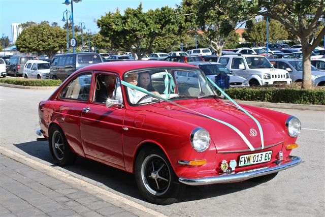

So since last this thread was updated some time ago, we the, Retrovan family has had a wedding since, and my little Girl has done and gone and married.
To the couple, only the best for the future, to the Fastback, you have never looked so good before baby.
Here are some pic's of the day.
Arriving at the venue
One proud daddy of a beautiful young women..........
Anti she cute, .........watch it..........
One Very Proud Daddy,

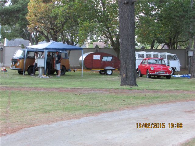

So the Fastback has once again done her pilgrimage to George Show this year.
Yes, I wanted to take the Oval Beetle, but due to the Oval/Split change over this year, we used the Fastback to join the Fugly for her last trip.
The Fastback behaved like a star, her performance like a super star, her drive like a luxury tour bus.
The type 4 running like clockwork, the 34ICT's saving fuel, and adding power.
If you not sure by now, the love between me and the fastback runs deep.....
But the wife understands, and is OK with it. ....
Till next time
