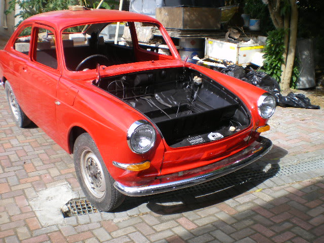

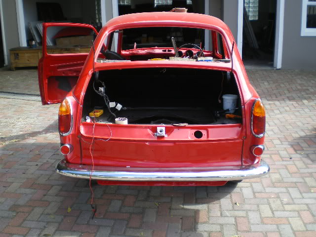

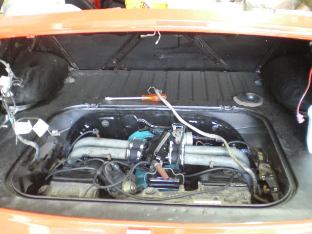

Connected the battery, and charger, then attached the wiring.

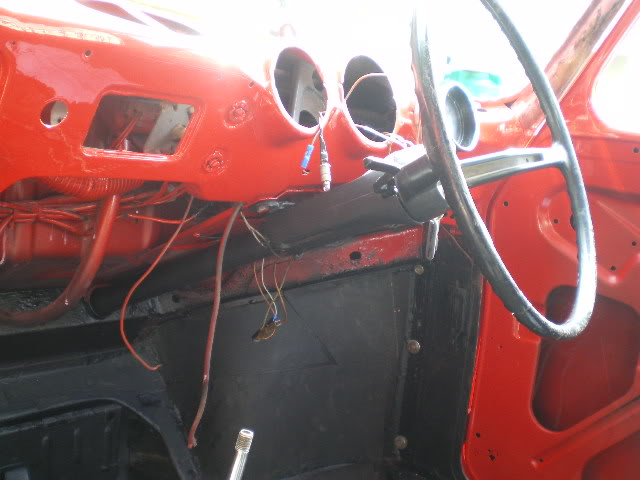

Now I have to tell you that it would seem as it guys have adapted the wiring as the original switches broke down, Holes were drilled and toggle switches fitted, wires were cut all over and rerouted to the toggle switches.
Started by fitting the "NEW" steering column, which has
a new Ignition lock switch, and
a reworked Indicator/High beam switch. Then the Head lights went in, as well as all other lights through out the car. These were temporary wired with an earth, so as to make the wiring accessible during fault finding.
Also found that the hooter relay was something of the past, and refitted
a new relay. Ran I missing wire inside the steering shaft to the steering box to make the hooter work.

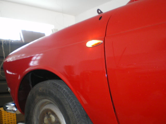

Connected the wing lights back to the "over Night park Light system", someone had turned them into wing indicators.
Fitted door switches, and got the cabin light working.Even got the Trunk light up and going...
Shorted all the ignition wires, and marked them, as the type 3 wiring will
not suit the type 4 engine, these have to be changed. Then fixed and tested all the warning lights on the dash. Dim Bright working fine, the light hooter is 100%, the sound hooter working as it must.
Must say the GOLF Mk 1 head lights makes the front end look like

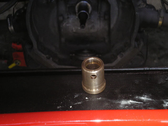

a $1 000 000., oh and then turned down the 75 mm dia, Reflectors down to 60 mm for the back reflector chrome housings, this I am happy with, as the old reflectors looked like

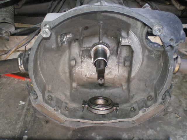

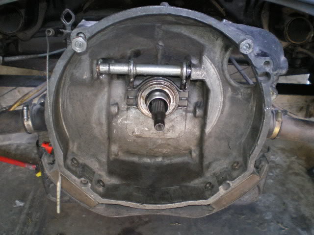

Well, the next will be the type 4 release bearing fitmint with my new made spigot shaft bush, (as per older post) to do this I have to change the Release bearing fork.
Then will be checking the clutch plate, and fitting the type 4 engine.
