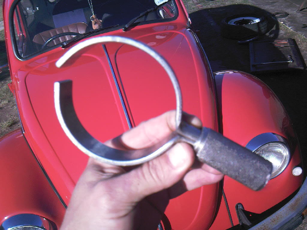

A mechanic has a couple of these.They are OG VW of Germany tools.
Can you guess what it's for?

Piston ring compressor

Thingy to check the case if the main bearing area is nice and straight? I'm only guessing here :lol:
Re: Guess the Tool
Yup!
This guy has a whole set of original German ring compressors and they realy work well.

Very nice, my dad also has an original set of German ones. You get different sizes for the different size pistons. They work very easily on a AC engine as you can easily take them off at the back of the piston when the sleeve start slipping onto the piston. Does he want to sell them Chris??
Re: Guess the Tool
No he unfortunately doesn't.He has some amazing tools.
