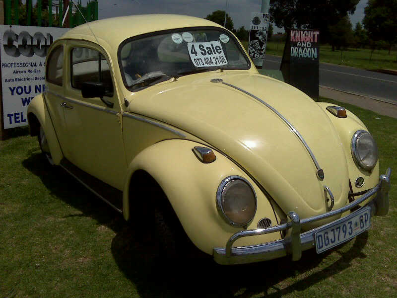

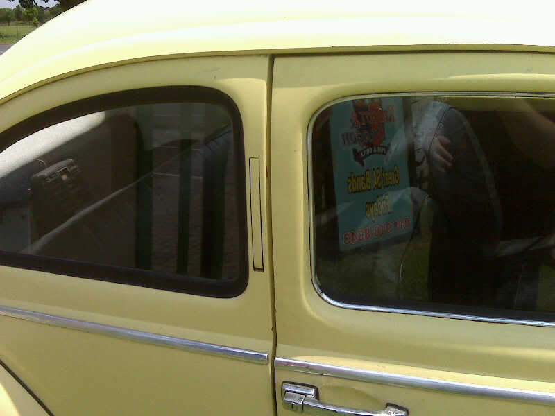

Ok. time for some pics
looks like a late 50's bug to me.
Re: 1960 Beetle question
early bonnet with wolfsburg badge! - check
Looks like a early porsche fluted headlight lense on the right ? :shock:
All beading there.
If you are looking for a nice early beetle project, this is looking better and better !
Maybe a 58?
