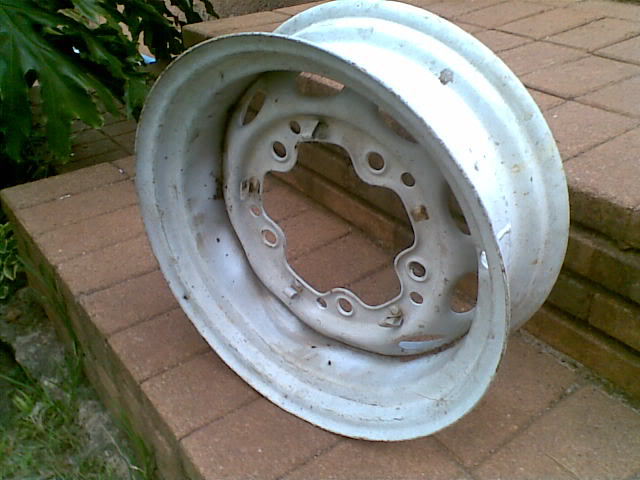

Ok,so ive done a test fit today on the beam,this is with a rostyle 185/65/14.im going to fit std rims when everything is done,i got my tyres today,front std rims with 145/65/15,,,rear widened 185/65/15
This is set at the highest point on my adjusters
widened rear,,,ill sandblast and paint rims before tyres goes on,and then a nice set of white walls from callooker

Hey Phillip, is that steelie a tad wobbled on the inside (6-9 o'clock) from the weld?
Lekker to here that you were able to source the front skinny wheels. What are those commonly fitted on?

Thanx splitz,,,,,hi hloni,no the rims r perfectly straight,theyre just very dirty.i got a set of smart car tyres for the front (145/65/14),now i battle to get reversable adaptors for the disc brakes :cry:
