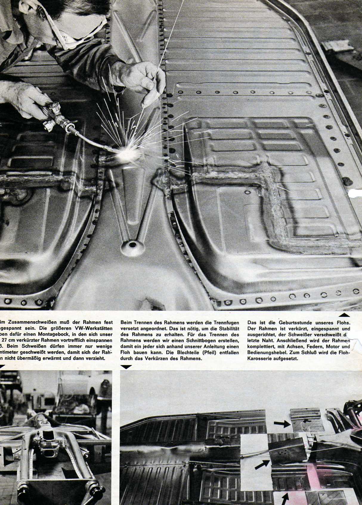

This article from the 'Guthe Fart' magazine might also help (hope your German is not too rusted!):
