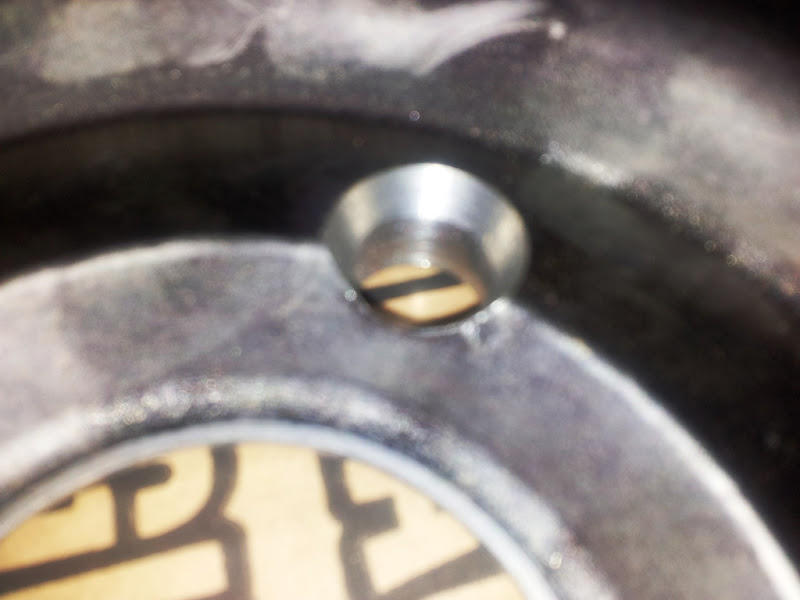

Shoddy, Sharp and careless machining. Not impressive. Horrible shamfer.
INCOMPLETE THREADING!
Insult to injury. after +4 weeks of tension, they didn't clear the calipers.
R480 a piece. I honestly expected more attention to detail and quality. Not impressed.
I can't afford to drive out to Pretoria to kill someone so We decided to complete the threading with a nice M12 1.5 (I think) thread tool. Didn't take to long to do by hand which just made it even more insulting that the job had been botched the first time around by Maugene.
re-threaded and cleaned up. High tensile bolts installed.
0.8mm Aluminum spacer installed to clear the calipers, had to be filed down by hand to avoid issues. Just some generic thing bought from Midas. Multi PCD C#@p isn't much fun.
