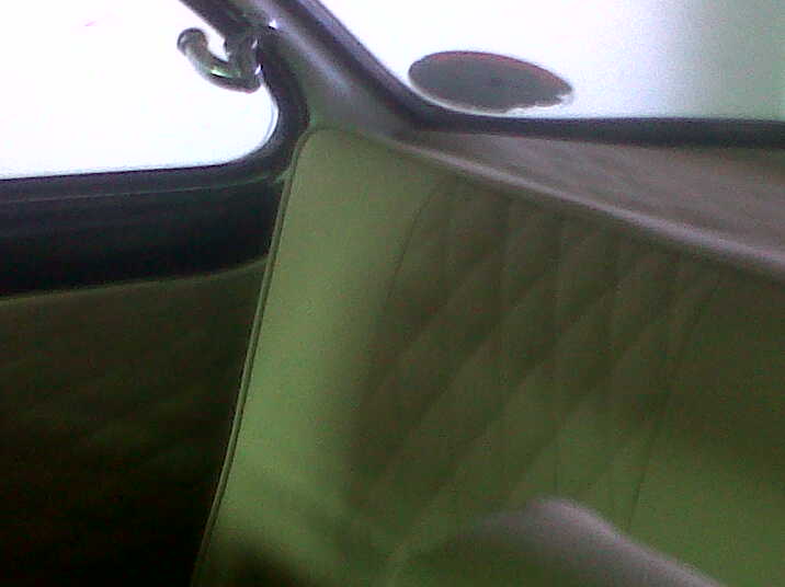

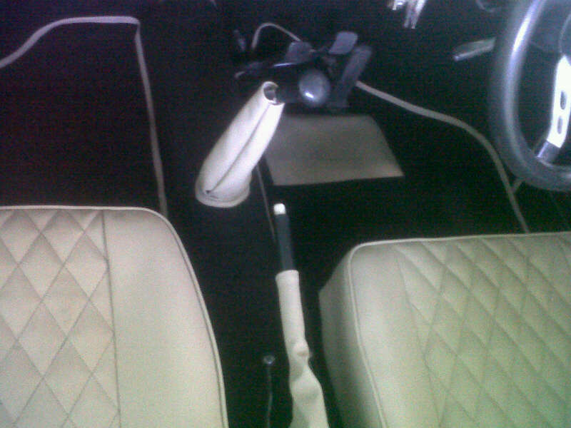

My jam jar as it is at the minute. It's just waiting on final polish, various chrome bits and some interior detail. My apologies for the poor picture quality.

Cool pics...
