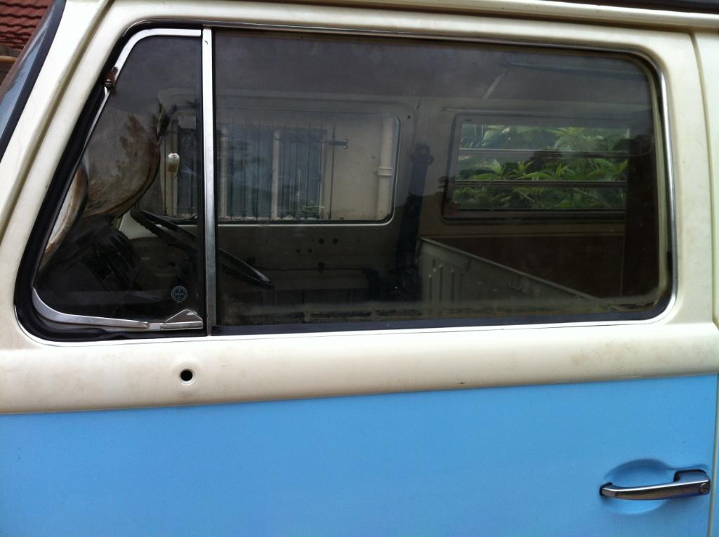

Here's some comments from my restoration in 2012
And is it soft and does it work, is it local supply or import, will you fit mi......Sorry, got carried away...
[/quote]
LOL Herman, I’m getting good at this as this is the 2nd Kombi i'm replacing the outside window scrapers.
The 1st installation was a lot easier. I imported German quality from Busdepot in the US. It was a perfect fit and simply clipped in at the bottom. The beading was curved perfectly.
The 2nd order was from another supplier and a bit tricky. There were fewer clips to clip into the bottom of the door and the profile of the beading was not correct. I had to bend the beading to fit around the corners and had to shape the ends to fit into the frame. It is soft and easy to shape but flimsy.
My other mistake was that I didn't fit the window and window winder first. It cost me some time to strip and re-do. I hope this info helps.[/quote]
