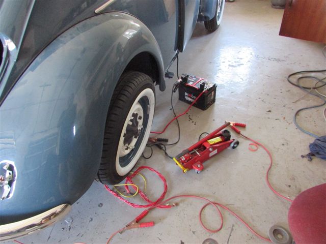

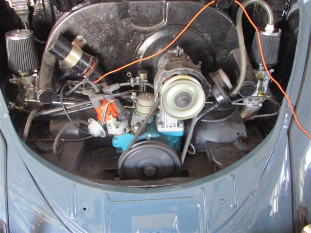

So today i got the Battery cables into the car, and gippoed the solenoid with fly wire,
fitted a lead to the coil, and gave the engine a few turns just to get oil pressure, when the oil pressure switch turned off,
I added fuel to the carb's by long fuel line to tin, and started her.
She started idling by herself, and then gave a back fire.
Realising the age old fault, that I had piston 3 &4 plug leads mixed up, changed them, and restarted her.
She idled like a dream, when to the back and pulled on the accelerator cable, and she roared with excitement.

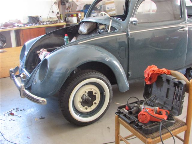

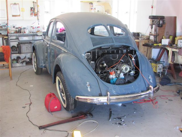

so here are a few pic's, for you addicts.....
So now you see the hash job to get the motor running as the harness has not cleared customs yet...... all Santa's fault.....
Here is motor running very happy..
Valance and bumpers on at the back
as well as the front
So till next time.....
