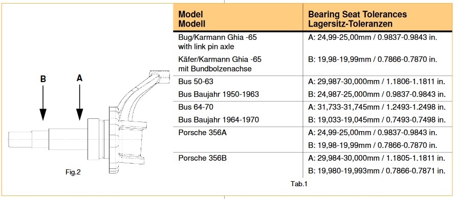

Actually the early king and link pin SA Models had the thin axles I think it was up to the 1200 models, my baja used to have a thin axle on one side and a thick on the other had to get the early 25mm id bearing from bearing man. The thicker axles were fitted to later models, I eventually swapped my thick and thin axle for a set of fully rebuilt thick axles years ago

After Edmond made his post, I had to check my facts. I was sure I had a picture somewhere of the spindle sizes.
Well, it turns out that early spindles have smaller inner bearings but larger outer bearings than the late spindles.
See below for sizes.

@Tony Z can you please repost this pic of the difference in spindlesTony Z wrote: Sat Sep 30, 2017 9:49 pm After Edmond made his post, I had to check my facts. I was sure I had a picture somewhere of the spindle sizes.

Front stub axle dia. from thin to thick changed in 62/63 beetles locally. If your beam has a steering damper then it should have the thicker dia. stub axles.
