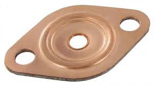

If as said the two are connected to the same place but on different sides, you can fit a small casket on one side and a full size casket on the other, this will ensure flow, regardless of exhaust build.
