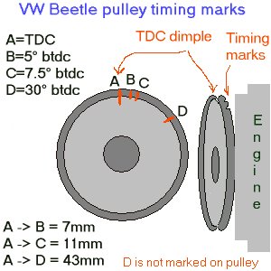

My crank pull has a notch on the outer flange and a groove to the right of the notch on the inner , set the timing on the inner groove with a timing light. Dwell is 48.
Any comment on the above.Is that the right timing mark.

the concave "ding" on the pulley (looks like a hammer blow) indicates TDC.
Set Idle to the 7deg mark
I'm not sure how accurate this is but here it is with some measurements
