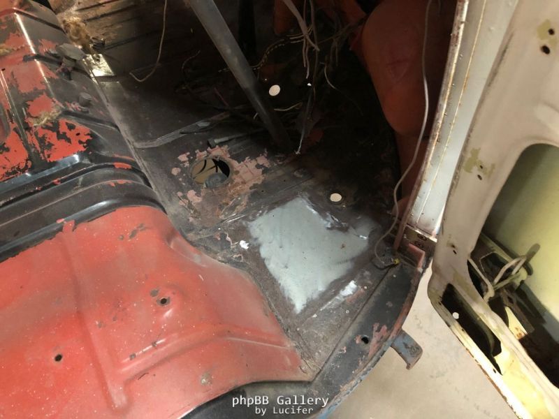

More hacked area's to repair. It appears it must have had a watercooled conversion in some point of its life.
Removed dodgy section of front floor.
Rear tail lights hackjob being welded up.
Test fitting donor engine lid. The one on the bus was a replacement from a very late model split, so could not remain with its incorrect catch.
The RHS rear end of the bus has had a knock and will need some straitening.
Sections of engine bay being replaced that was also hacked out.
Valence mounts/brackets also been cut and installed from donor bus
Battery tray repaired
The sandblasting of the chassis and engine bay will be left until last to clean all the surface rust off as well as help remove the surface impurities on the welding as well as making a great surface for the primer to adhere to.
