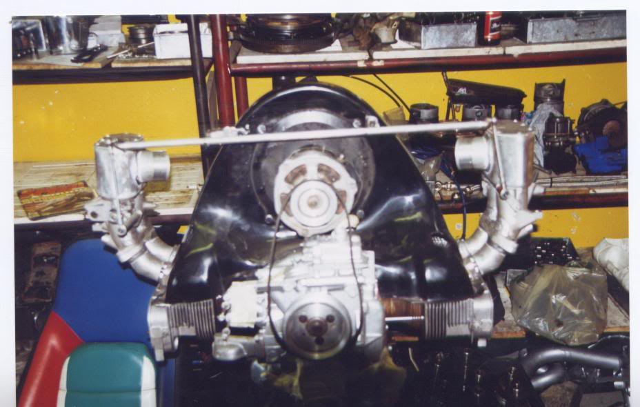

Take a look at the engin bay this was a 2.1L Type 4 in my one Oval bug and I built a all steel fan housing with the twinport fan in the housing and sealed the engin compartment from hot exhaust air comming in and had a long 4th gear in there for highway croozing with out any cooling problems
And this is my Other Type 4 2.3L turbo motor with 2x BMW 50mm throttles on and a modyfied glass fibre and steel fan housing and all the bottom tin ware still bolts to the top housing for propper cooling
