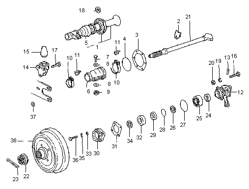

So... I spent another saturday fighting with the bearings, and came off second best again
I used john's method of loosening the sideshaft assembly from the suspension blade, but I could not get the assembly apart from the axle. I beat it with a hammer eventually (against my better judgement) and it still didnt budge. I eventually came to believe that I had misunderstood John, but I just found this picture and it looks like part 12 should come off the shaft.
Anyways, at this rate I'm about to give up and take it to a local mechanic who says he can do it (using the parts I bought) for R1000 (4 hours at R250/h). Is that as much of a ripoff as it sounds to me?
btw, how important are part 14 and 15 (bumpstops)?
