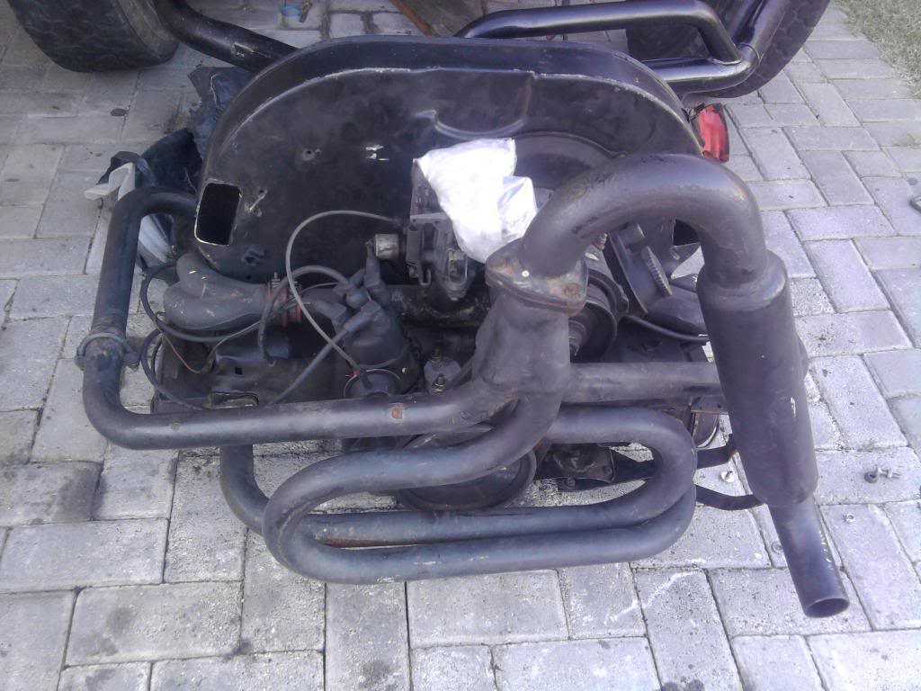

Today I got a chance to work a little on my Buggy's engine.I've had the exhaust lying around for a couple of months now and thought it would look good on the Buggy.What do you guys think.
Also took the heater outlets on the airbox off.They will be replace with stainless steel plates.

Nice! I like the J-pipes going above the valve covers. But how are you gonna fit the horizontal part of the J-plates?

Do you think it will be needed?Pine wrote:Nice! I like the J-pipes going above the valve covers. But how are you gonna fit the horizontal part of the J-plates?
- Posts: 15033
Re: My Beach Buggy
Yes, it protects the pushrod tubes. I lost two tubes (and almost all the engine oil) on HW1 in a forest outside George when I drove over a branch, and it flipped up. Had to do some walking for help
- Posts: 11732
Re: My Beach Buggy
I was thinking of making a guard under the engine that fits onto the bar or just refitting the j-plates.There is more than enough space.

Do not leave the J-Plates off! FULL STOP!
- Posts: 11732
Re: My Beach Buggy
Why?

Even though its an open buggy - airflow!!

I've heard the same thing, and I do have them on, but for different reasons. Uhm... they look nice when they are nice and blue and clean... uhm, branches jumping up and ripping out push rod tubes, yes, but air flow I don't buy unless you are referring to the forget-me-not.hitlers revenge wrote:Even though its an open buggy - airflow!!
Blou-gemoerte never had them on (had to save on weight...

The forget-me-nots are on the engine.athe j-plates I don't think will be essential as I've seen plenty trikes and Buggies with no j-plates on and the run cool.

If you have J-plates lying about, stick them on, they don't weigh that much... So they won't do any harm...
You know, like, just in case...
