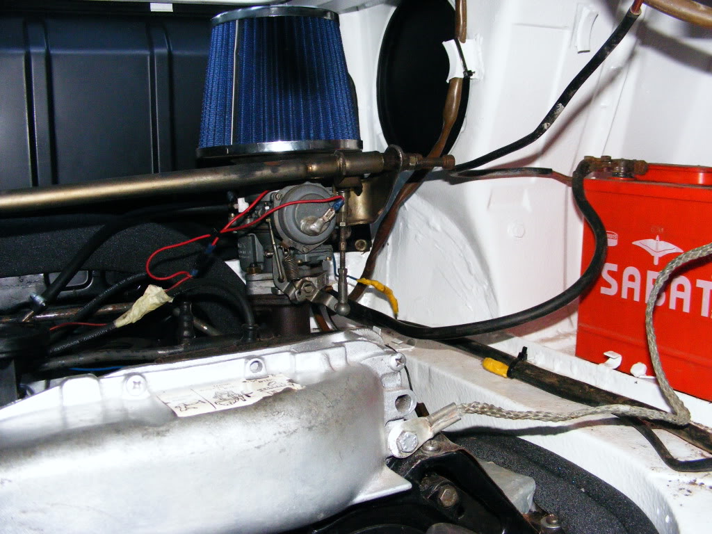

HERE IS YOUR PROBLEM:
The 34 PDSIT carbs from the 1800- 2L engines are incompatible with anything but the standard VW aircleaner setup with it's long intake ducting. I did experiment extensively with those while monitoring results of air/fuel mixture and cylinder head temperature. The 74- 82 versions of the 34 PDSIT carbs have a special pressed in emulsion tube that causes leaning out of the mixture at high airflow rates. That was done to cancel out the richening effect of pulsing airflow caused by the long thin intake pipes of standard system at high engine loads and speeds. Type 3 engines with offset aircleaners even had different jetting between left and right carbs to compensate for effect of pulsing in different length pipes. By the way PDSIT's from 1700 had different emulsion tube with different characteristics
When driving at high altitude with standard jetting, difference is not as bad. But at low altitude/high atmospheric pressure, mixture will lean to the point where cht and egt is high... causing pistons to over-expand and collapsed skirts happened.
If you really have to keep those aircleaners, then re-jet on a dyno. For a start, air correction jets will have to come way down. Mains increased slightly, and take it from there. It will be thirsty at light loads.
For lowest fuel consumption and best results, fit the standard aircleaner setup complete with the standard setup that directs hot air at light loads and temperatures below 30 degs. With standard jetting, an immediate increase in power will be felt as well compared to the cone filters. Been there, done that. And double checked and tripple checked, as i could not believe the difference myself.

Dawie wrote: When driving at high altitude with standard jetting, difference is not as bad. But at low altitude/high atmospheric pressure, mixture will lean to the point where cht and egt is high... causing pistons to over-expand and collapsed skirts happened.
This explains why she ran so well in the High velt on the way to KKK.
Trouble is I don't have the standard air intake, I never did the bus came from the PO with a cyclone type filter. I have been keeping my eyes open for one but with no luck. Perhaps I should bite the bullet and fork out for some Weber's they seem to be less troublesome. Also there are more guys with dynes that can work on them (here in Durbs anyway).
Thanks for the insight guys, many times over.

Dawie. If I replace the cyclone system that i had on originally. do you think this would help in the interim? It is about a meter and a half of 50mm steel pipe. about 50cm from filter to the "T" junction and then about another 30cm to each carb...
I know its not the real deal but it should help right?

That should be fine if T junction is in the middle and pipes from carbs to T about equal length/ + - 23 to 30 cm each.

the "T" is in the center. Cool Ill pop that back on :) Thank you again for your help...
