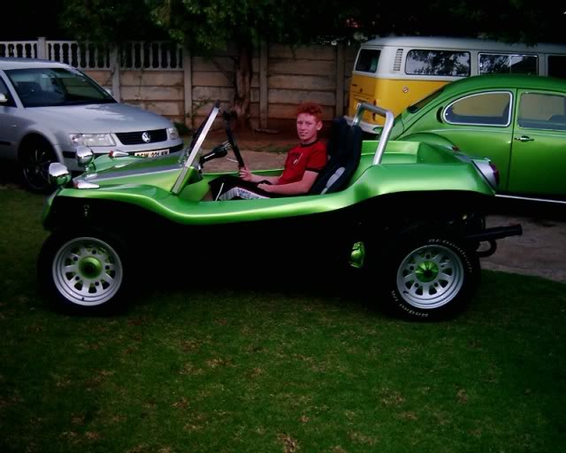

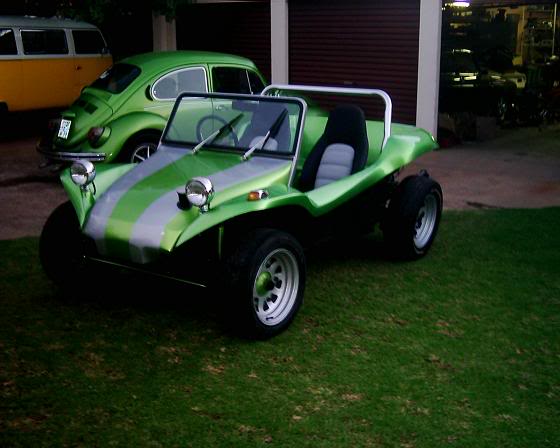

I like that idea, B/fanatic! This is a buggy IMPI built a few years ago - the craftmanship was excellent, but the 'shine' on the floor was a bit too much for me personally..
Yet, the end product was absolutely stunning, and captured many aspects of my 'ideal' buggy! :drunks:

Wow - that does look very nice. One of very few buggies where chrome bits actually work IMO. What make mag wheels are those (s'cuse my ignorance).
Impi is the VW Indoena! :hangloose: You have to admire his work.

AirPower wrote:What make mag wheels are those (s'cuse my ignorance).
No problem - those are standard 10-spoke white steel rims (Smiths?) painted silver with colour matched drums, the pic below might give you a better view. That's Mini-Me-IMPI behind the wheel, also known as Wouter, firstborn of the Botha clan!

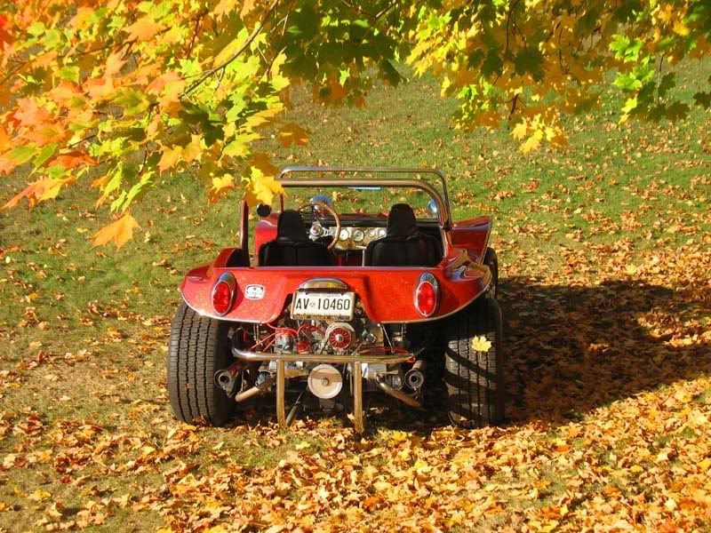

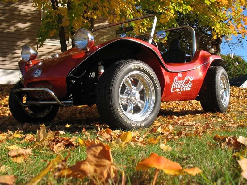

This so-called 'Coke buggy', is very close to my idea of the perfect classic buggy so I give it an 8/10, features worth mentioning:
- Body - not original Meyers Manx, but very close
- Polished Torque Thrust wheels - the ultimate buggy wheel - on WIDE rear rubber!
- Large chromed headlights, <'68 chromed Beetle tail lights, chromed Beetle number plate light housing
- Chromed single, angled roll bar
- Deep-dish wood-rimmed three-spoke steering wheel
- Discreet classic Manx front bumper
- Not clearly visible on the pic, but a central-mounted filler cap
- Metalflake colour
What I do not like on this buggy:
- That chrome edge around the body
- The rear bumper (makes the buggy look 'longer' and decrease the departure angle on off-road driving, yet required by the law)
- The side pods. I personally prefer the raw look of the fibreglass fibres on the sides, painted matt black
- The rearview mirror - almost as wide as the windscreen!
- The seats - the headrest makes it look like something from a Renault 5, I prefer low-back buggy seats
- Black dash, I feel it should be the same colour of the rest of the buggy
But as I said, it is my personal opinion - and I wouldn't mind at all if HW2 looked anything like this :wink:

I would like to say the following:
1. Low back seats. Even though they look good, they give no protection against backlash in an accident.
2. Rear bumper/bar. WIthout, no protection for the engine against that idiot that rams you from the back.
3. Single angle roll bar. Although the lines are clean, if for some reason you end up in a roll, it will not hold up like a 'supported' roll bar (to distribute impact forces)
4. '68 chromed Beetle tail lights, chromed Beetle number plate light housing. Looks like it has been slapped on as a last thought.
But as you say, Buggies are personal taste, so we will always disagree....
