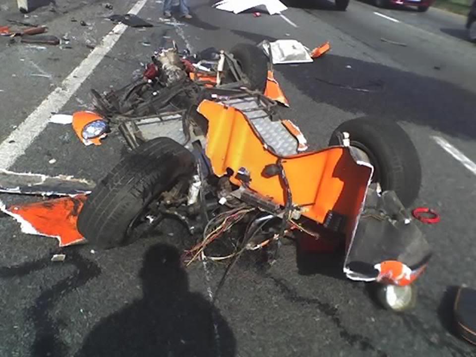

Since the accident (read: the death of Hot Wheels 1 :cry: ) almost a year ago, I have decided that I absolutely MUST get another buggy - OK, the Bay is nice and lekker - but it is a workhorse at this stage, and there is no time to take it off the road for a period of time to restore it, so it has to wait a while (and work!)

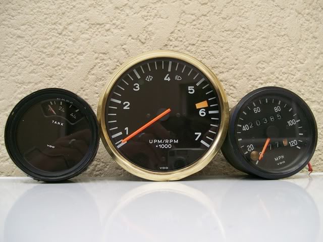

The aim of this thread is to keep the Forum up-to-date with the progress on rebuilding the buggy (yes Blitz, with pics). The idea is that the end product will starting to take form on the Forum, as it does in my garage, without giving away too much information. I have already started a few things, but will tell you more about it later. I have also gathered some goodies for the buggy, starting with the gauges that will be fitted:
Yip, they are Porsche - well, actually a mix 'n match set. The tach is from a 914 - and is ideal for a Beetle engine, since it is calibrated for a 4-cylinder engine, unlike the 6-cylinder (more common) tach. The fuel gauge is from a very early 912, and the speedo is a generic VDO item. I took them today to Speedo Services for reconditioning, and I am delighted to announce that both the tach and the fuel gauge are working 100%! They will now be cleaned, re-assembled and the bezels resprayed black (I polished the tach's bezel, so that is why it looks like something from the engine room of the Titanic :oops: ), I'll be getting them back in a few weeks. The speedo will be replaced with a similar one, but with km/h.
I can really reccommend Pierre from Speedo Services in Fisher's Hill - they really know their job, and do outstanding work!

Good Luck Pine, only saw the pics of hotwheels 1 now for the first time, were you hurt in the accident?! My word, look at that buggy! Perhaps a full rollcage in the new one ?
karmakoma wrote:Good Luck Pine, only saw the pics of hotwheels 1 now for the first time, were you hurt in the accident?! My word, look at that buggy! Perhaps a full rollcage in the new one ?
Thanks Karma, that is a long and very sad story, everything here on TheSamba http://www.thesamba.com/vw/forum/viewto ... highlight=
:arrow: But I LIVE - and that is the most important. All injuries have healed, and I am fit as a fiddle again! :lol:

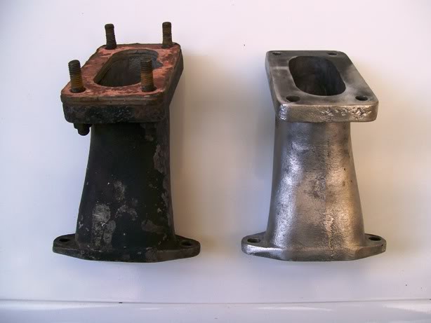

Gave one of the manifolds last night some treatment with a wire brush on the drill's end, the end result is quite amazing (although aluminium goes dull due to oxidation quite fast). Not finished yet, but in the meanwhile:

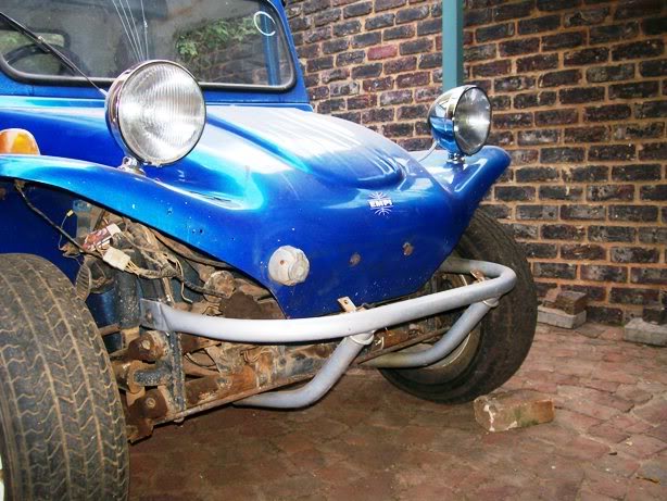

One of the very few parts that survived from HW1, was the original steel bumper (that came from an oval Baja many moons ago). It was not on HW1 at the time of the accident. Trial fitted it on the blue buggy:

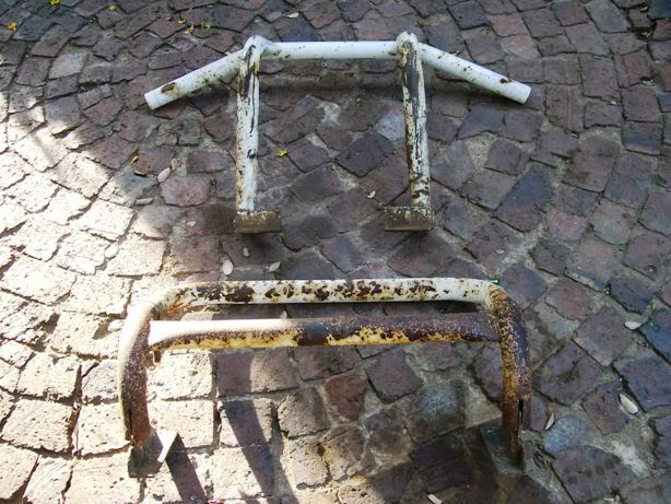

The original white bumpers (front and rear) were taken off, and are available under 'Give-Aways' to the first one interested. They are quite solid, heavy - and UGLY. Dibs to the first one who replies to the correct thread :wink:

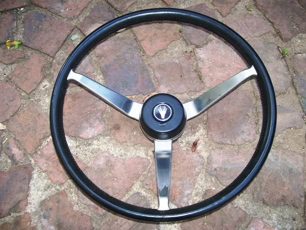

Swop meet find - an old Ranger (?) steering wheel, with a Springbok on the center cap for that 'olde school look'. Might be a bit too big for a buggy though, decision pending -

Pine, why dont you get the maifolds annodised? For example Silver?

Will keep that in mind, thanks Zero. How durable would a clear laquer be?

Pine wrote:Will keep that in mind, thanks Zero. How durable would a clear laquer be?
You are going to have hard times with laquer. It doesnt really stick well(enough) to aliminium. You can clean it off properly, prep the surface and paint your laquer. But in due time it will just peel off. You see, you need something that can etch into the aliminium. But then you loose the 'buff' that you just created. Best bet is to get it anodised aliminium colour(clear perhaps? not sure if clear anodising exists, havent researched it yet). It is very durable.

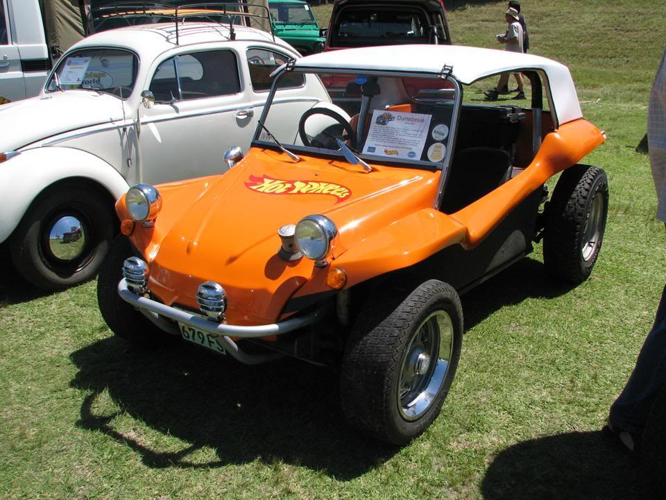

The pic above illustrates more or less all those factors combined, so you see what I mean? There is a very fine line between HOT and NOT, and it is mostly a matter of personal taste.

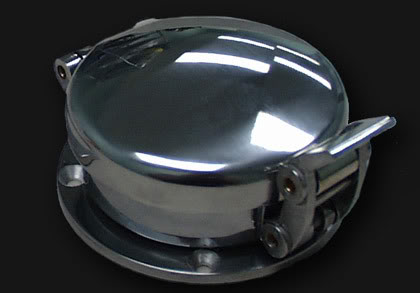

Starting with number 6 - the filler cap. I am looking for one of those large aluminium 'flip-up' filler caps, as fitted to racing cars and especially Cobras. Does anyone perhaps have an idea where I can find one - does not need to be new, just in a good condition?
