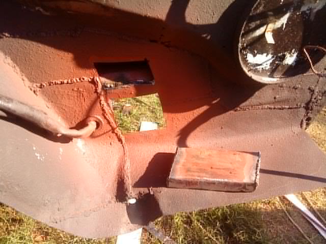

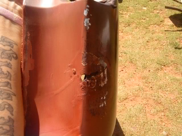

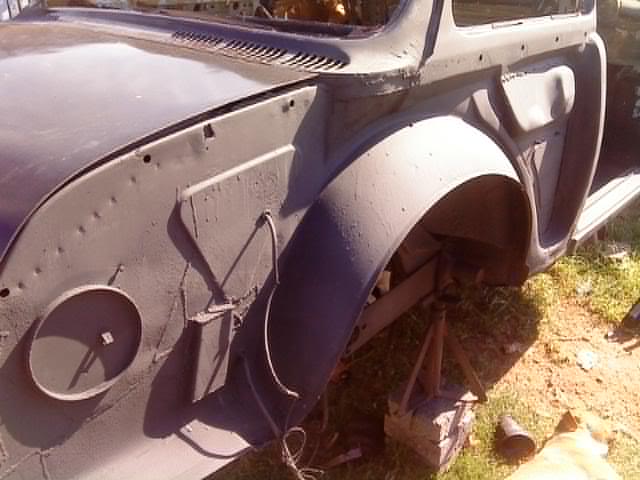

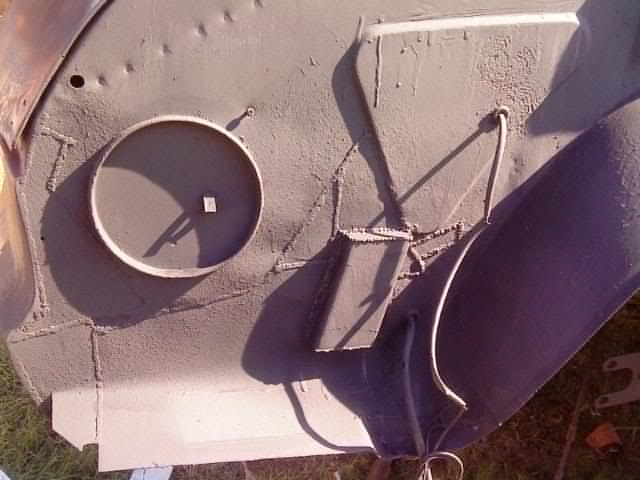

Remember the rust around the fuel filler? Weeellll, the opposite side did not escape as we had thought! Was hidden behind seam sealer and cables:
So that needs to be sorted out.
Some more panels are being checked and prepped, rust spots and dents here and there (and everywhere):

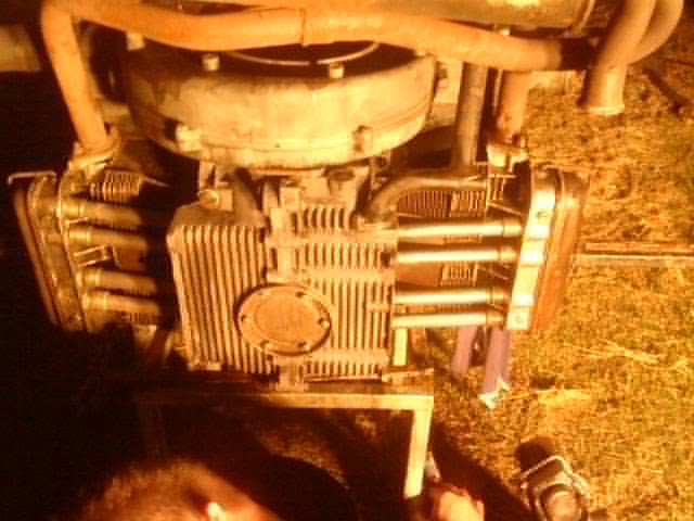

The engine also got a late night clean:

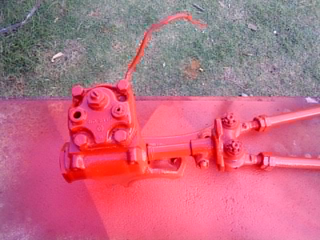

and then, Bugoff sent this pic to me, the steering box came out and he tested some of the final paint colour on it:
It's going to be one bright red Notch!

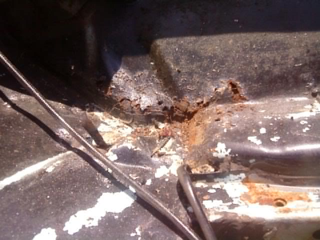

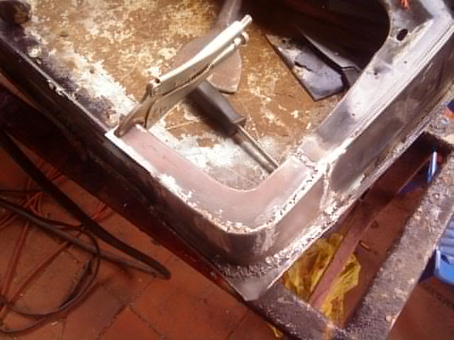

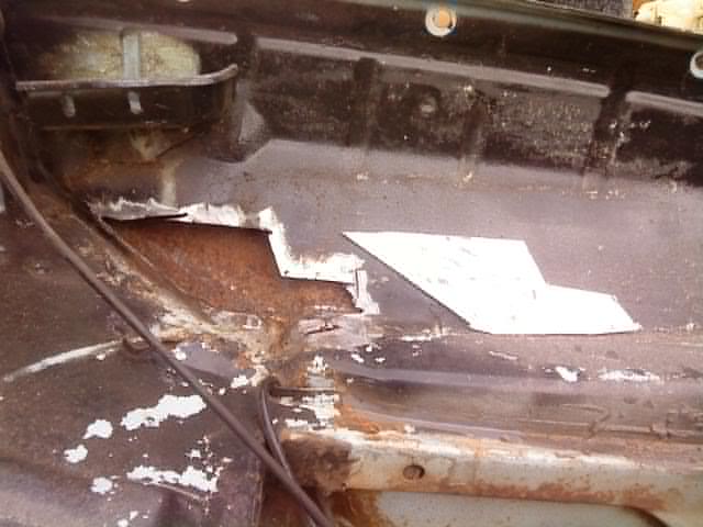

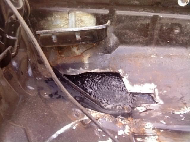

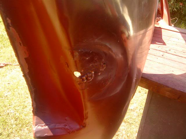

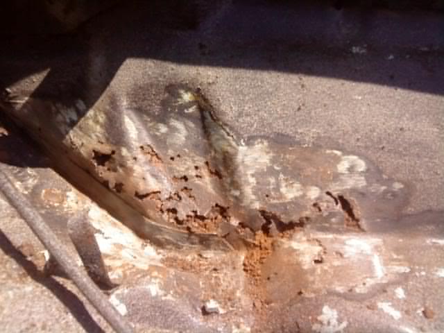

Remember this last (we hope) rust spot :
Well it is no more.

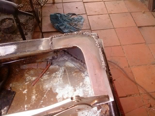

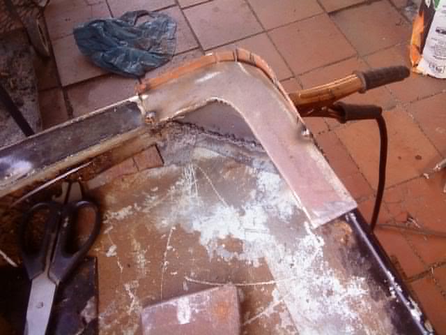

First of course, is the cut:

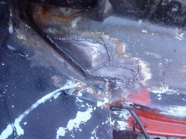

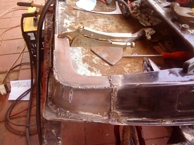

Then the prep:
and lastly the fix and weld (and very neatly done if I may say so!

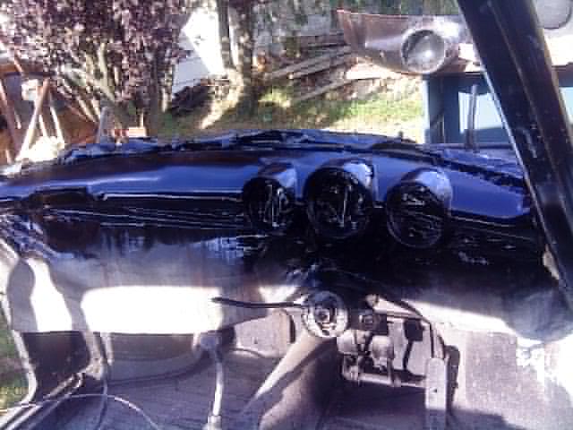

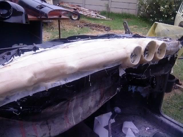

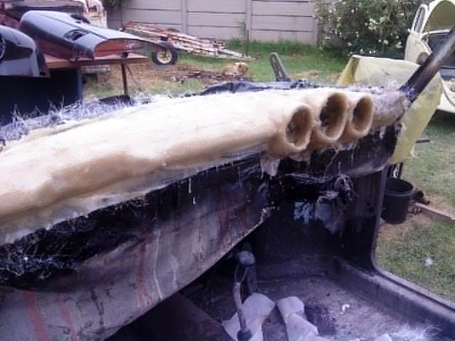

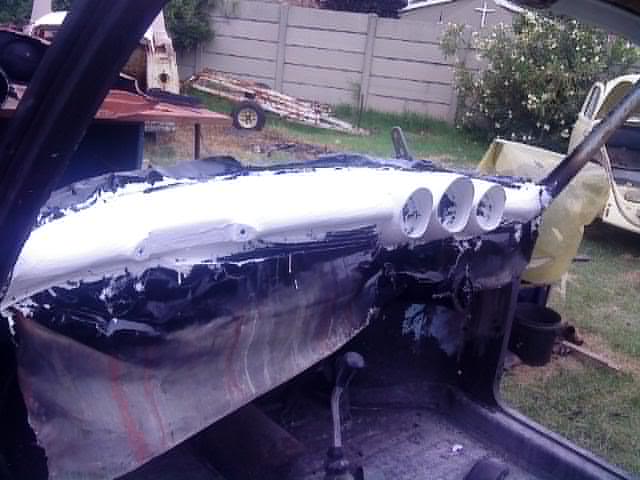

If you recall the original dash on my Notch is cracked, so Bugoff took it upon himself to make a mold from fibreglass.
Step 1 (and please jump in Ferdi if I get any of the steps wrong):
Make the original dash as shiny and non-stick as you can:
then add the gelcoat:
The first weave coat:
some chop strand
and finally the 2nd weave coat with some wood reinforcement to prevent it from cracking....
If this comes out nicely, we might just have a source for replacement Type 3 dashes!

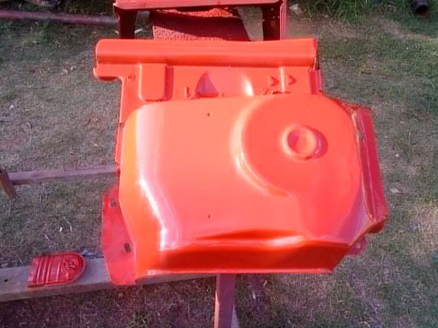

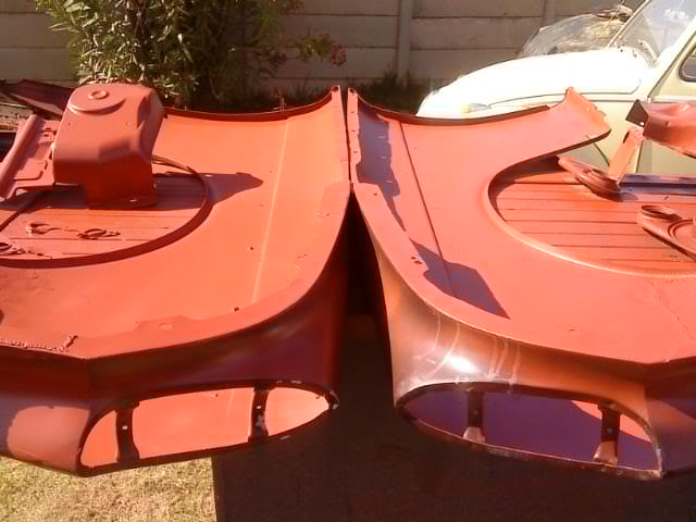

With that out of the way, and the red paint tin open, it seems that Bugoff likes the colour as much as me!

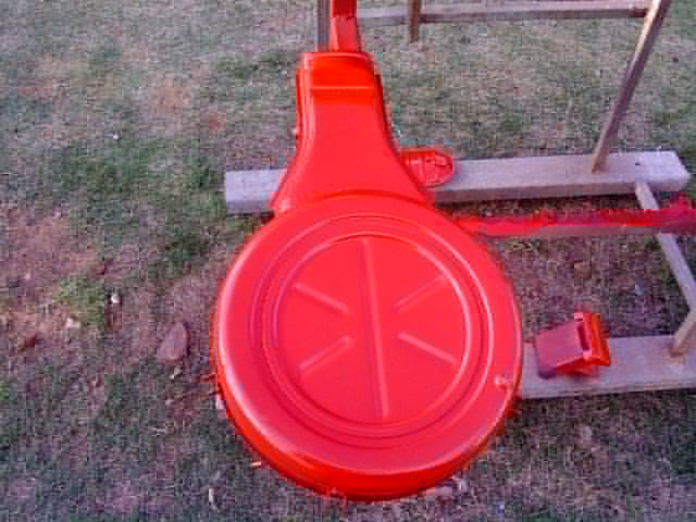

We have some red tin, metal, filters:
Some more red tin:
and a filter close-up:
Why be normal ?!

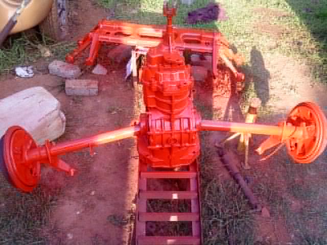

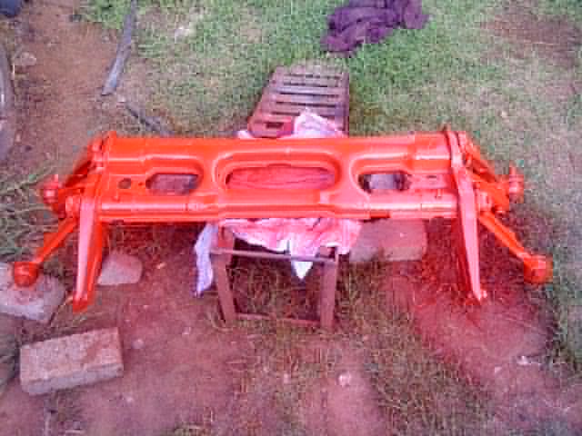

Then, the narrowed and chopped beam, HAHA, just a red beam
and a RED gearbox:
Did I mention this car will be red ?

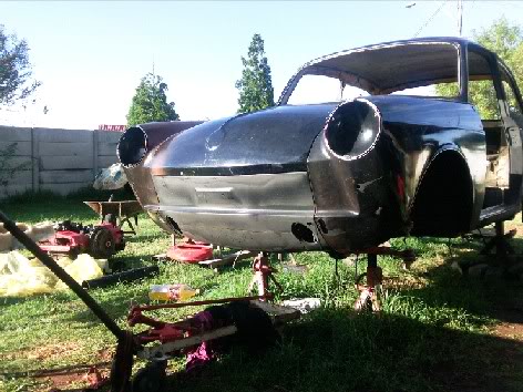

and after ALL the incredible hard work, we are finally back to this:
soon..........
