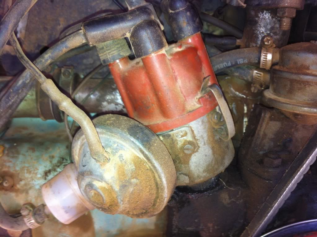

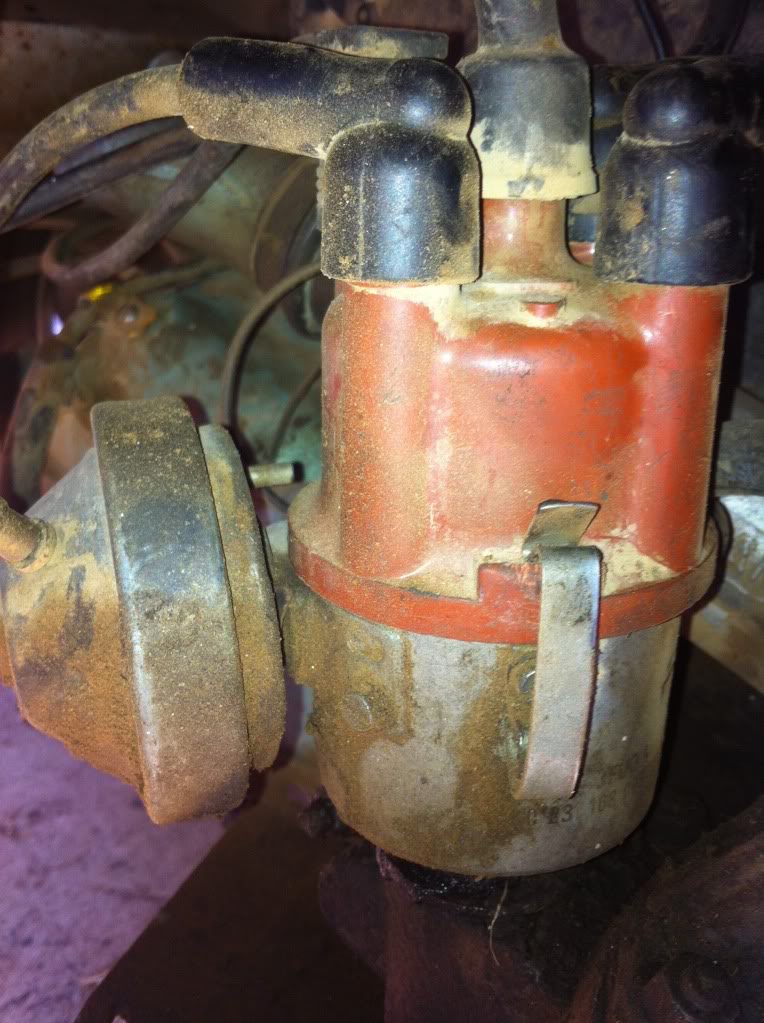

Hi Dawie
Sorry these are the only 2 picks I have. the guy is using it on A 1600 with mechanical ignition.... Go figure...
You wouldn't be willing to let the dizzy go would you?

Re: A bus named Grace
That distributor above is correct for the 2L, it's just before the electronic one was released. Is he not willing to part? Or are you specifically wanting a electronic ignition variety?
The correct distributor for a baywindow 2l indeed has the small single advance vacuum can and is similar to the 70's beetle one. USA models had a different dual vacuum can.
The distributor on your picture either had it's single vacuum unit replaced at some stage with a dual type, or it's from an overseas model. It's no better than the one that originally came with your car. Do'nt waste money on it.
Only purpose of dual vacuum unit's retard function is to reduce nox emissions as required by some overseas countries. This retarded timing at idle unfortunately also causes the engine to run poorly and hot and waste fuel. I would not connect the retard function as it's not required in SA.

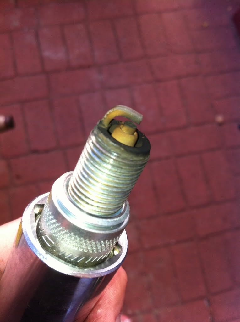

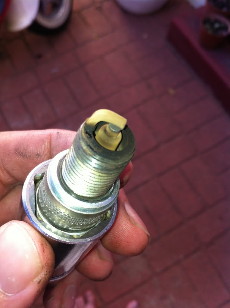

So Here are some picks of spark plugs....
1st is from Cylender 1 and the second is from Cylender 3
What do they tell me about the state of my combustion? I have no Idea.... what do you guys think?
