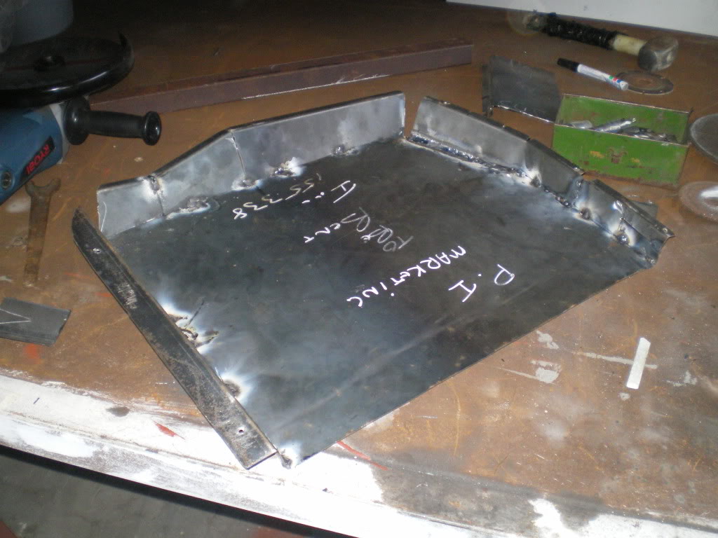

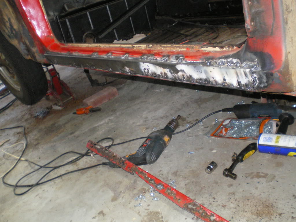

Today we have been packing all chrome parts for African Platers in JHB,
Cut out the rust around the battry box and built a new battary box from thick 1.6 mm steel, as can be seen, the parts are only tacked together, will be TIG welded in the morning
Have also cut out rusted sill, and tack welded in the new one, ready for TIG Welding.
The small parts have been refurbished with rust removed and a good coat of paint ready for the big assembly when all is done.
Seats and carpets are also beeing done, so all isfine, for now.
