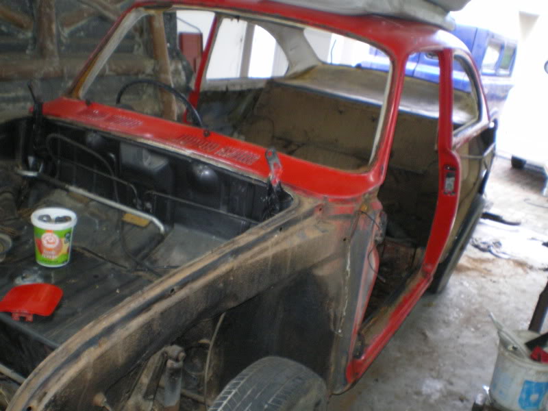

Have started stripping it for prep. ready for spray.
Have stripped all panels, and found lot of surface rust, but no holes. :roll:
Will be taking it right down to base metal, e-coating all parts, and repainting it back to RED
Car was colour code 12 (think black) (or white) then Red and now back to RED :shock:

To update, I have striped all carpets, padding, sound proofing out of the car, and now found rust holes. :shock: But have also found a 1972 1/2 cent , this will reduce the cost already. :lol:
Found a lot of water under the sound proofing, this has been there for years, Note to self;- Make sure all window rubbers are water tight. :idea:
Will be sending seats for upholstry (white) and redoing the carpets (Black)
All loose panels and bits will be sent out for paint striping, e-coating and repainting.
Will be spending most nights wire brushing rust, covering with "Rust Converter" and priming the next day.

But the more i wire brush, the more it seems local to normal spots, with surface rust between.
Must say that I am on the 2nd drilling machine already, not to mention the round wire brushes that do the work.

For rust removal, try one of those small "one hand angle grinders". Wire brushes are available for these. They spin at around 11000 rpm's instead of a drill's 3400 rpms. Sanding discs are also available for these.
For a drill, there is a type of composite black plasicky looking wheel thingy, (made by scotch an others). A bit expensive, but they are excellent and efficient for rust removal uses. Seems like they bite through the rust, instead of wire brushes that sometimes gives the impression that they are sort of being "lubricated" by the rust , or just "spreading the rust around". (Not the correct tecnical terms, but once you have tried the various methods, you may understand what i mean). Best is to first use the "scotch" wheel, or coarse sanding disc, followed by the wire brush.
Re: 1967 Fastback with type 4 FI motor
Hi Dawie,
Fair comment.
The thing I find is that as most panels are shaped like a women, more curves then straight parts,the sanding disk as well as the scotch disk tend to leave flats, and removes badly needed metal (to keep the car in one piece) :shock:
I do not know if you have ever worked with "rust converter". Well for those that have not, let me explain, :puterwork:
The hole idea of rust converter is to retain as much metel as possible, not like the old days when you were told to "remove all rust or it will come back". 8) So all you want to do is get to the 1st layer of metal with rust pit marks, this can be done with a good wire brush. You than paint the rust converter onto the area, ensuring full wetnes, sit back and see it change from pink to black.
When black you know you have stoped the rust and converted it chemicaly to an non-oxide product. Now you have to coat it within a day to stop the oxgyen from getting to it again. Please note it must be a final coat and not just a primer, as a primer is not air tight.
Should you use a under floor rubber compound, you then have a strong fix. And here endith the lession :?
With regard to the grinder, I have one with brush, but this is not for the faint hearted, boy what a ride :shock: and not late at night :cry:
Well let me at it again,
Till next time
:hangloose:

Have done most of metal work in inside the fasty and have sealed it to the big bad oxygen. :evil:
Trying to get pic's on, well here goes.......
