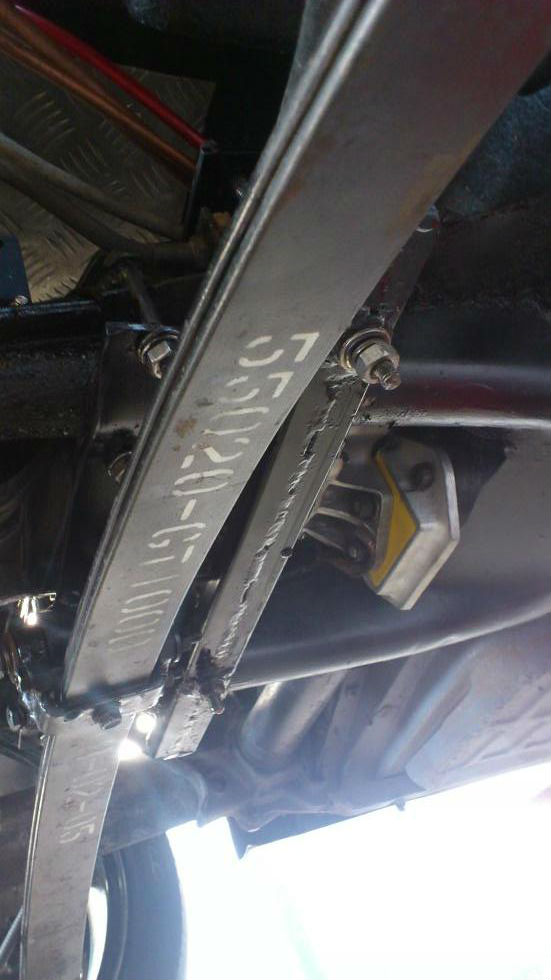

Started on the home-made camber compensator:
Made the bracket for the mounting point.
Used a 1400 nissan bakkie rear blade.
Only need to find a better way to connect the blade spring with the shock tower.

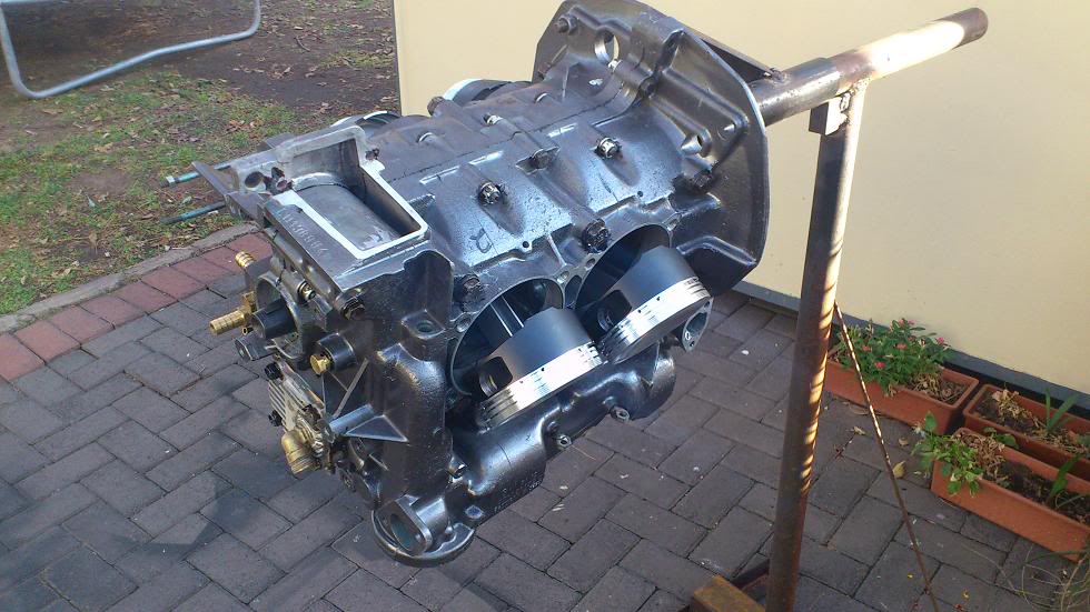

Onto the motor - The internals:
Oil squirters inplace
Counter weighted, long stroke crank in place with an adjustable cam gear
Pistons in place
Up to this point all went well, but measuring the deck height,found the cylinders short by about 5mm
Now I'm thinking - big boost with aluminium sleeves or manufactured Deutz Diesel sleeves? Instead of having a loose spacer in there it seems better to go with the cast iron. what do you think?

Nice to see some Progress
There is nothing wrong with using spacers under the barrels to space the barrels out for lower CR
You can get nice tight spacers made
I have once got the barrels slightly machined down at the bottom so the spacer sleeved over the barrel and sit very tight on the barrel as it is part of the barrel
My 2.4 Buggy have also about 5mm spacers under the barrels

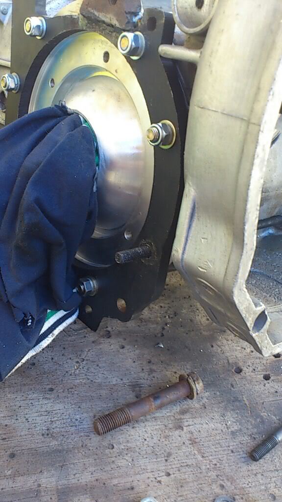

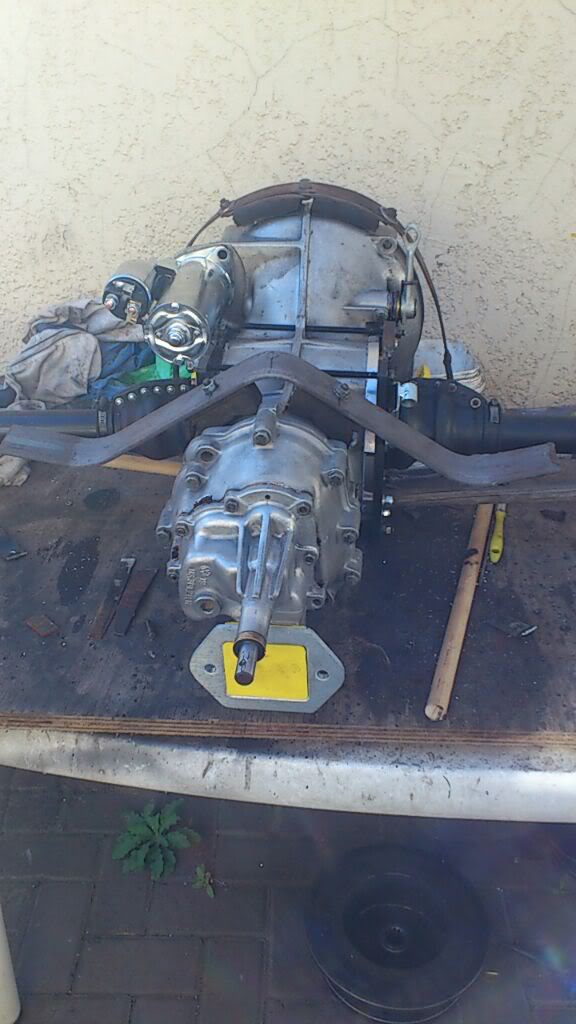

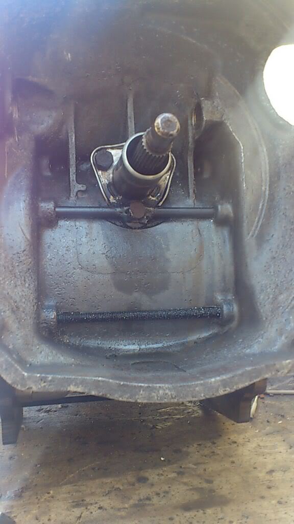

Got the gearbox and I'm busy strapping it together.
I've had to replace 4 studs with through-bolts because the studs stripped out. I'm torquing the studs to 20 N/m, that's what my manual says.
Don't know about interference with the flywheel/clutch yet, but I don't think it will be an issue.
First one:
Second one:
Added 2 more at the top:
2 more through-bolts on the bottom and I'm done.

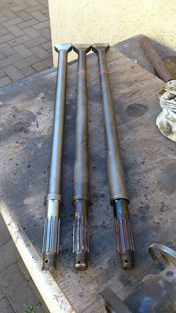

So far I've installed the new axles with new bearings and seals and new axle boots. These axles are supposedly made of a better German steel that can twist due to torque without breaking - new axle compared with the old ones:
Rear drums are done, studded and cross-drilled/balanced.

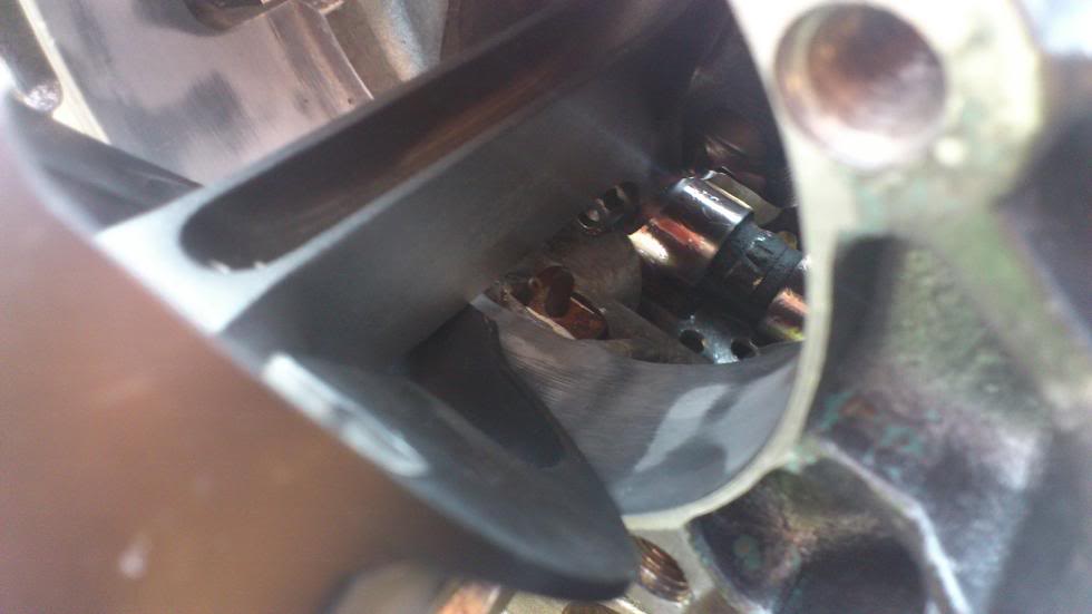

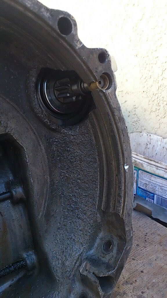

Here's one problem I don't know how to solve yet - the starter bush is loose in the gearbox casing. I don't want to glue it, but how to stop it falling out? I don't think peening the case is going to work - the magnesium is very brittle.
What would you do?
First one:
Second one:
What would you do?
- Posts: 14992
Re: 2012: 1/4 mile in 12 seconds
I suspect loctite is one of few options...
Some starter bushes are much looser than others
I just make a few punch marks inside the ID where the bush go and then fill the starter bush with Oil by pressing the oil inbetween 2 fingers to Squeeze it through the Oil light material for lubrication
then Wipe the outer side with Thinners and fir the Bush with Locktite
Soooo, fixed the bush with some shim stock.

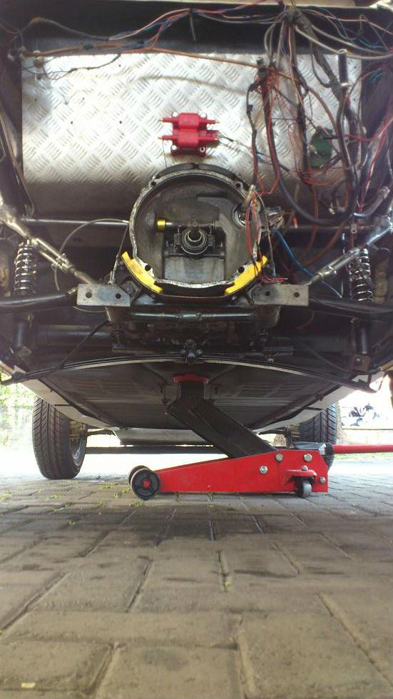

Today the straps are done and in place.
The gearbox is now strapped over the bellhousing and another over the body. I thought about putting it over the nose, but I'm worried the nose can be broken off.
Reason: the motor drops the rear suspension down, while yanking the front nose of the gearbox up under acceleration, so this is to protect the nose and mounting.
So this is the idea:
And this where it's in place.

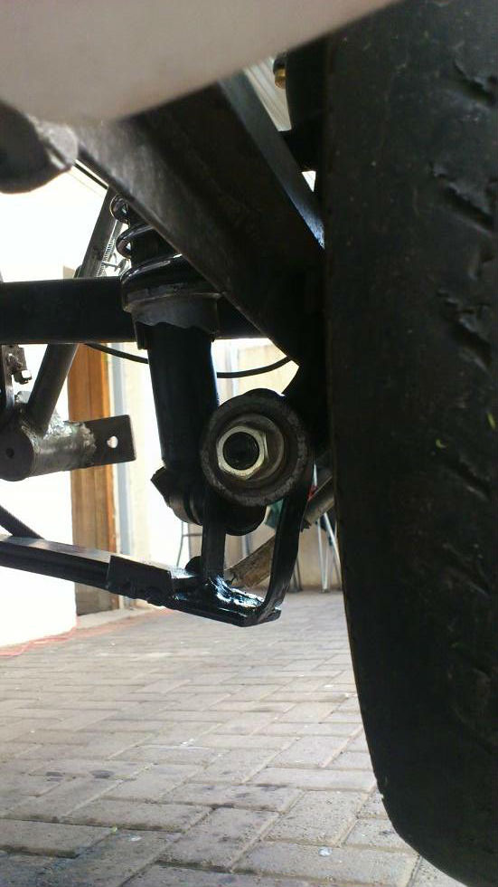

The camber compensator (home made) is also in place.
Why a camber compensator - it works like a Z-bar and as you know, with the buggy, the Z-bar is usually lost.
The connection to the wheel is mounted on rubber - I used the front anti-roll bar's large rubber.
And I'm done. This is now a highly modified rear suspension with the coil-overs, relaxed torsion bars and the camber compensator. I'll only find out how it feels on the road once the motor is done. Still waiting for word from the engineering shop regarding the cylinders.
