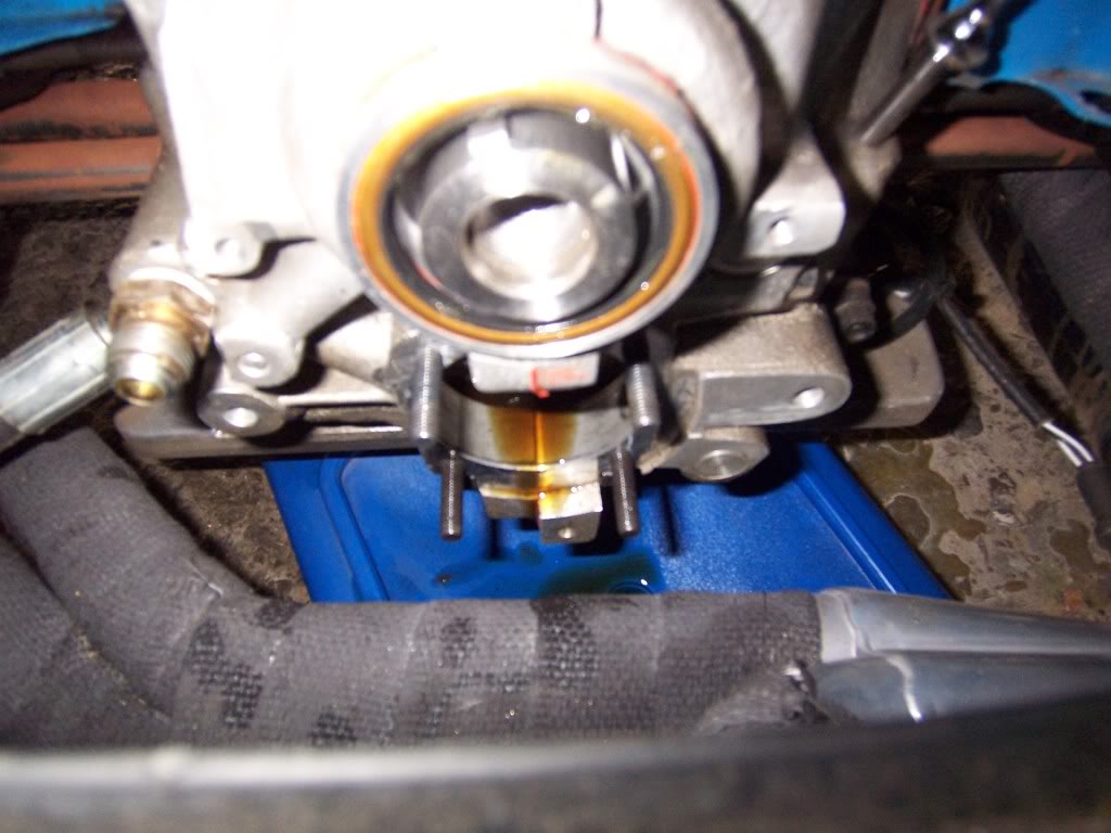

For those that are interested, the hydraulic clutch kit:
It installs inside the tunnel and attaches to the passenger side pedal assembly bolts.
You also need to work through the front of the tunnel - through that little inspection plate on the nose.
I put the feed pipe through the old fuel line opening to go to the supply reservoir (for hydraulic fluid)
Clutch pushrod needs to be installed in place of the old cable hook
Rear slave cylinder

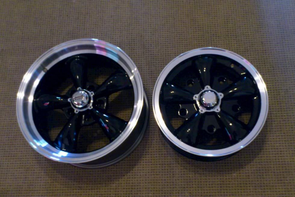

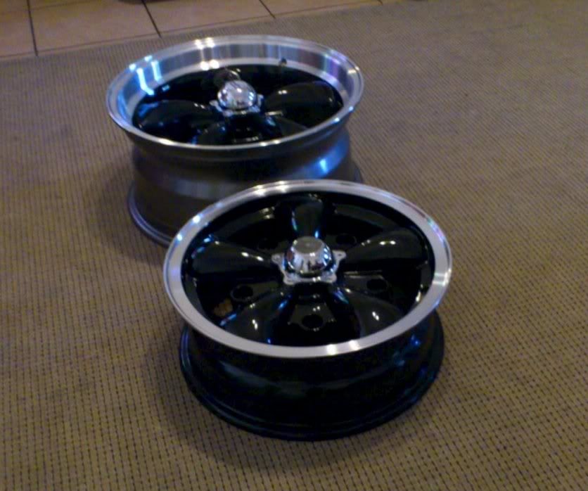

Change of wheels - looking for 17" in the back.
