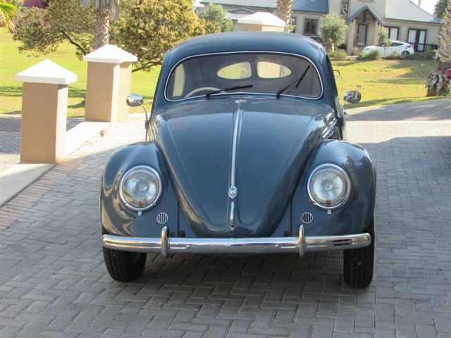

Herman,.... thanks for response,... but I am a bit "deurmekaar" now?
Yes type 3 pan,.. included is the bucket ?
it seems that the current "assembly" hooks in at the bottom,.. and is kept in with the trimring at the top.
I have not stripped anything yet,. but this pic was taken after paint a while ago, it's too long ago can't remember!.
Somehow I need to fit something for the light assembly to be attached too. reason for all this questioning is to avoid purchasing,... only then to find out that it might not be worth it. !!! don't travel at night !!!
regards Haans
regards Haans

It looks as if your glass and reflector is mounted to the chrome ring such as some older beetles.
You would then remove the reflector and glass and mount the new semi sealed glass/reflector combo to the same place as the reflector.
BUT if you like your rounded glass then leave the old glass mounted to the ring but fit the semi sealed in place of the reflector using the mounting clips of
the reflector. Looking at your photo of the head light this option will work best.
Think that will work, its what I have done with the 52 Beetle and the Fleetline split bus.
