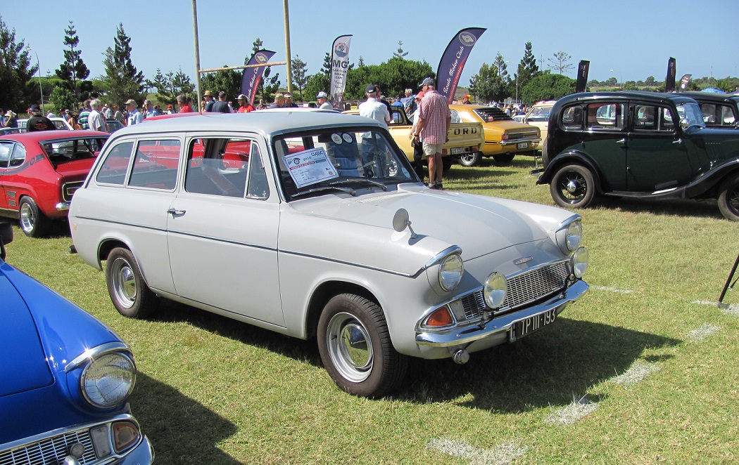

Saw pictures of the George show and then this:
Almost looks like the Anglia's younger brother?
