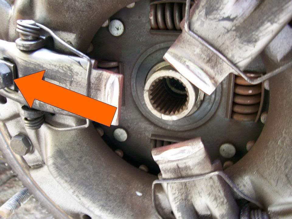

And so the amazing Bus clutch story and woes goes on. It's been 8 weeks since the release bearing went, and almost 12 000 kms (city driving) later. About a week ago I noticed that it was getting harder to get the Bus into gear, so I climbed under it, and gave the clutch cable a bit more tension by turning the large wing nut at the end of the cable. End of problem - or so I thought

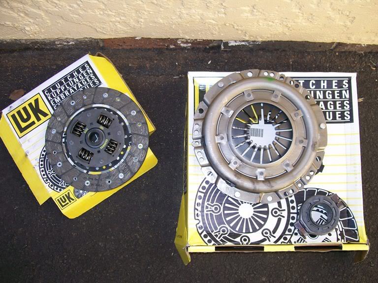

At about noon today, while in Boksburg, engaging a gear became increasingly difficult, to almost impossible. I had a bad feeling about it, and bought a new LUK clutch kit (luckily spares shops are quite common in Boksburg.) Phoned the work and told them I'm taking the afternoon off. Got home, and started to take the Bus engine out. I was afraid that the 'house brand' Midas release bearing was on its way out, and thought one couldn't go wrong with a new clutch kit anyway (R 650 at Autozone).
When the engine was out at last, I saw that one of the bolts (marked with an arrow on the pic below) was loose. Funny enough, the other two had some welding on to keep them tight. I don't even want to think about the amount of damage it would have done if the bolt came completely undone!

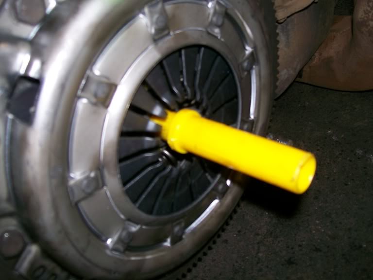

So, it was OUT with the old clutch, and IN with the new!! (Old one available for free to anyone who wants it)
I know it is technically speaken advisable to rather have the flywheel machined first, but mine still looks good and I simply did not have the time to have it done.
This is what the complete new kit looks like:

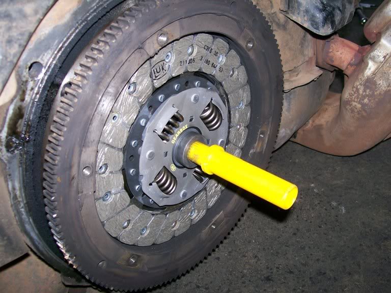

Friction plate installed with (supplied) centering tool:

PS: The 'house brand' Midas release bearing is still brand new, and shows no sign of wear. It looks identical to the one supplied with the LUK kit. Put the new one in though 'just in case'.
Diaphragm installed:
Put the engine back, and the gear change is better than ever!!

Your old pressure plate is the wrong one; it's the older type with the ring in the centre that someone has "modified", and that's what killed your old release bearing. The new diaphragm style is correct; no wonder it feels better.
