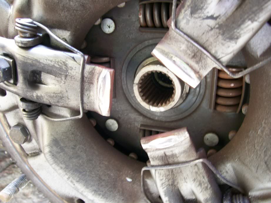

Well after all the above was finished (and it sounds easier than it was :? ), I had a first look at the release bearing, and this is what I saw:

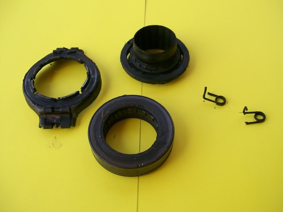

The release bearing had completely broken apart, and the 2 spring clips were broken too ! No wonder there were no clutch...
What you see below is usually supposed to be 1 piece, with the clips attached to it :shock:
Clutch luckily looked fine, and not damaged. I don't like these '3-finger' clutches, but I'll replace it later

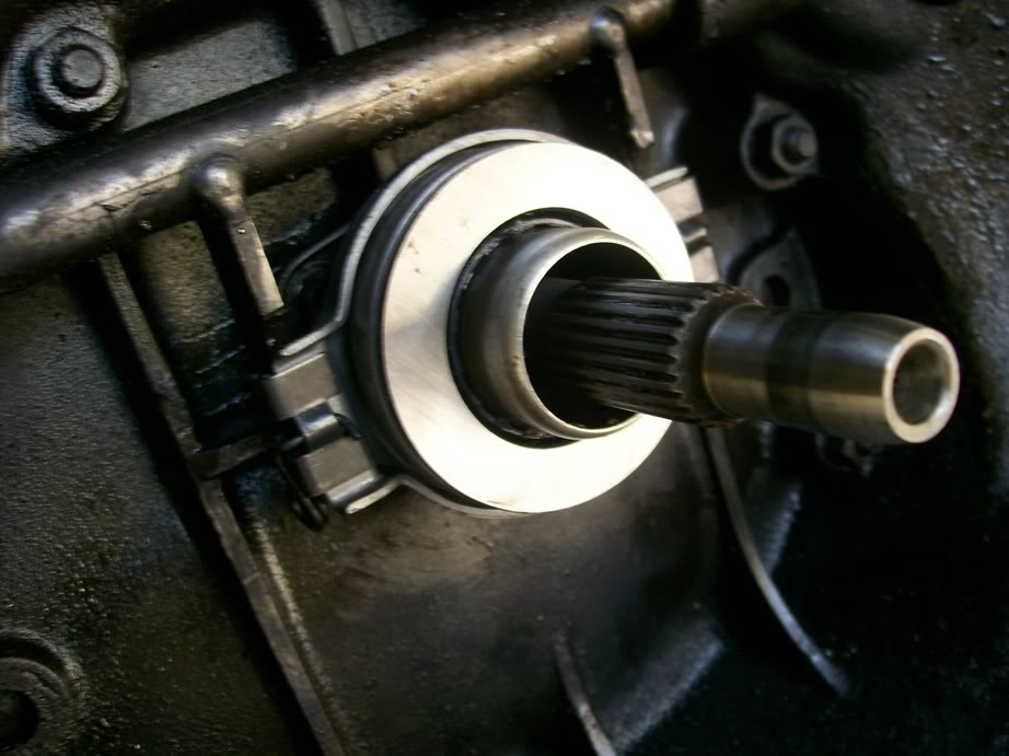

So I jumped in the pool and had a good scrub in the shower afterwards and quickly went to town to get a new release bearing with the wife's car. Luckily Midas had one at a reasonable R 60.00. Got back home, smeared some grease on the sliding tube, and put the new bearing in. I'm not gonna bore you with the replacement sequence of the engine, but it is basically the removal sequence above, in reverse :wink:

Thats a problem with the later type box with the thrust bearing guide tube. When the bearing seizes , it will try and rotate with the flywheel / pressure plate and jump off the fork.
The older one which had two deep grooves in the fork (and no guide tube) that the ears of the thrust sat in would not easily allow the thrust to rotate .
That orignal design was required because the early VW's had carbon thrust bearings, with a thrust "pad" on the pressure plate fingersthat the thrust ran up against.
P.S that noise that you heard was the straw that broke the donkeys back--- probably had been making inaudible (from inside a kombi) noises for quite a while

Ja that old 3 fingered P/Plate is not the correct one for that newer thrust brg. I cant see from the pics, but it might not even be a diaphram type unit.The newer guided thrusts are made for the multi fingered diaphram unit.
is there a chance that that PP had a thrust pad that was removed to allow the later thrust to clear the PP fingers when the pedal was released.
I would imagine that this is the case here.
I havent studied clutches in great detail, but I have never noticed a VW diaphram with 3 fingers (and no thrust pad) that run directly on the thrust bearing

You defintiely have an old style PP with the ring on the end of the fingers removed. As everyone has said, you need a diaphragm type PP. If it were me I'd make a new matched clutch kit a priority as your new release bearing won't last long. LUK/Repco clutches are OK quality and not too expensive, between R700-R800.

Single port engined Beetles and buses (69-70) had the earlier style with the three-fingered clutch with ring that contacts the release bearing, while dual ports (71 on) had the diaphragm style PP (is that what you mean by multi fingered?). Each style has a different release bearing and they should not be mixed or you will have instant or early failure of the release bearing, as you experienced.
Of course, most cars have had parts changed over the years, so you can't rely on the model year. The clutch required is dictated by the transmission. If your trans has the guide tube in front (FIF) of the release fork, then you need the later style clutch kit; if it has no guide tube, then you want the earlier style.
Your bus has the guide tube, which is correct for a 71 bus, so you need the later, diaphragm type clutch kit.
