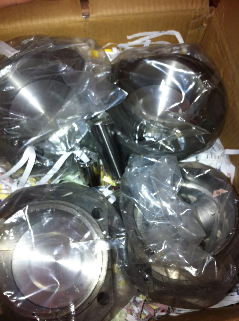

Look what Oom Rui Got me
Now should i put them on my self or do I take the risk of some one else doing it?
Thanks Rui
Thanks Rui

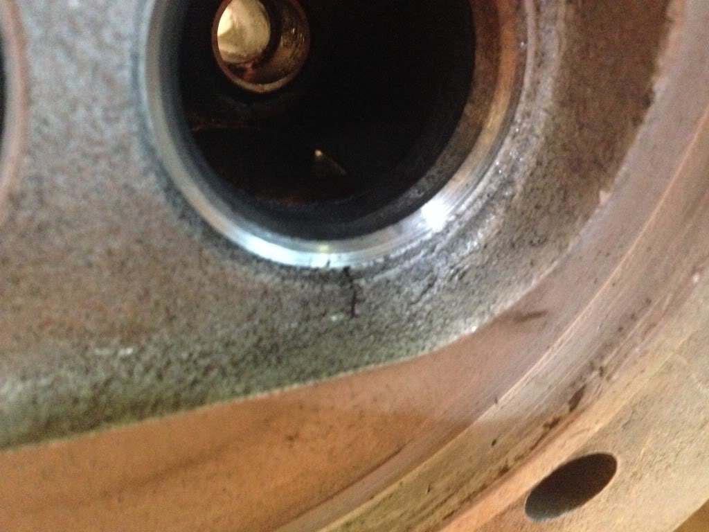

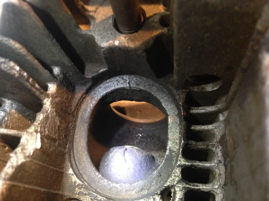

After digging through a lot of scrap motors I managed to find a matching set of heads. one from my original motor and the other in a junk motor a bought. I took the plunge and re-coned the heads. My oe head had a blow through hole in one of the Exhaust ports and the (scrap) head had some issues with dropped valve seats. after many hours working in the engineers (he let me do the work and didn't charge me for the use of the equipment. we managed to weld up the hole and sort all the other bits out. so yesterday I start replacing some missing studs and seating the valves. then I see it...
A nice big crack from seat to port stud so here are my options.
#1 try weld the crack (cheapest but not to shore if I am willing to risk all my new parts and time and money on a head that is clearly very fatigued)
#2 try find a good second hand replacement locally and fork out to have that refurbished and risk spending money on a head that could tern up more gremlins.
#3 buy brand new heads from the UK or USA (Not the cheapest... not OE parts but peace of mind that the parts are new...)
so here are the questions... I'm leaning to option 3, and after chatting to my Bank manager (read wife) she is keen for that as well. does any one know of brands to stay away from or can recommend a good brand that I can look into?
Heaps of thanks in advance

If you have your head set on new heads, then dont change your mind. You will be happy with new heads and old heads will leave doubt in your mind
As far as I know, the heads to go for are AMC heads.
Even the Marine uses them for his cores

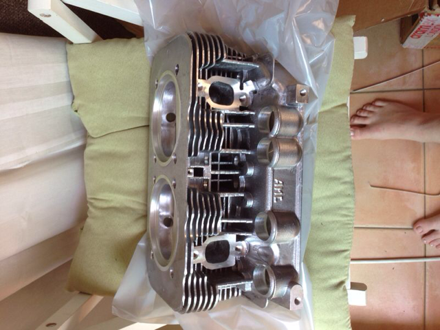

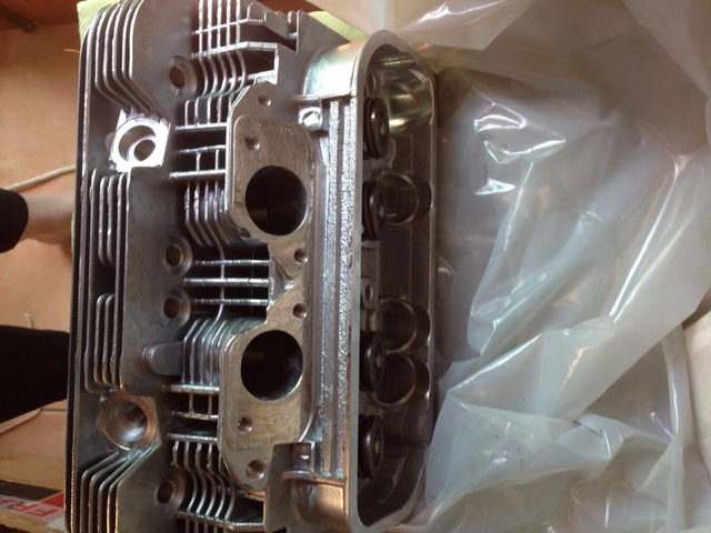

SOOOOOO i have news... very good news my new heads arrived from the UK yesterday!!!! i do have picks but i cant get them off my phone. Now as soon as i can get a gap the rebuild can begin!!!!! HAZA!

no that was just to my brothers house in london got it all here plus customs for around R2k.
