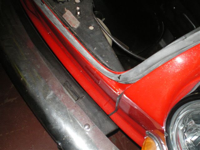

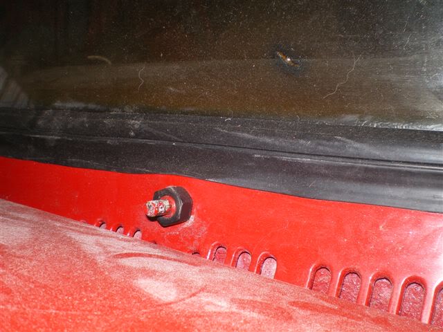

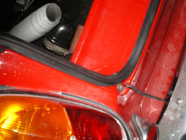

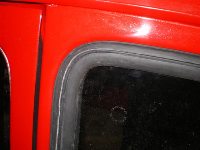

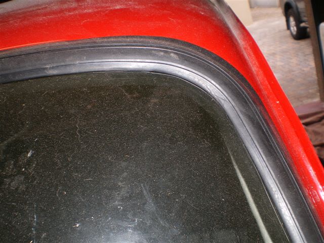

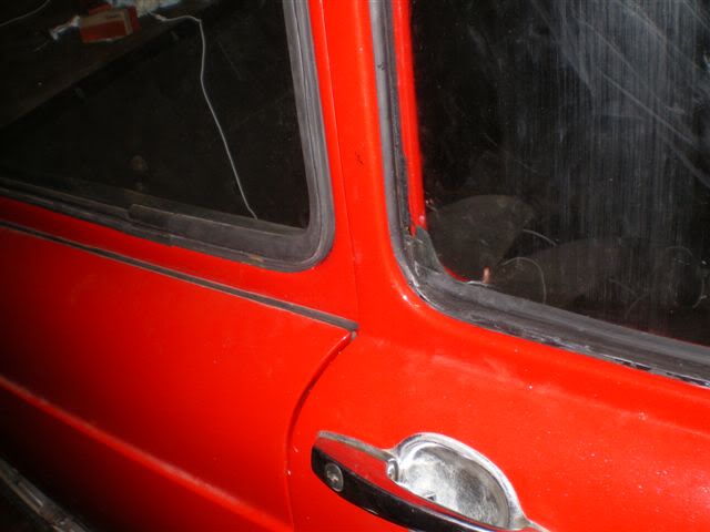

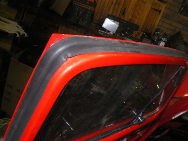

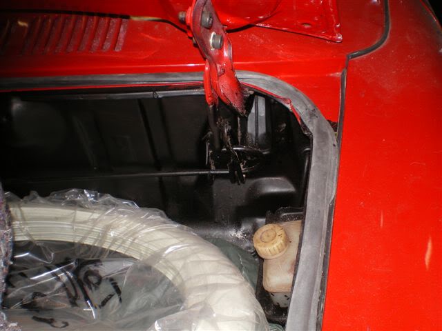

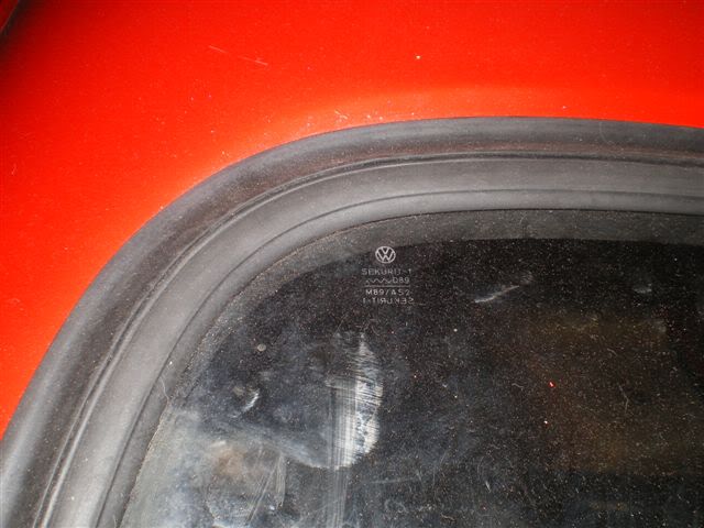

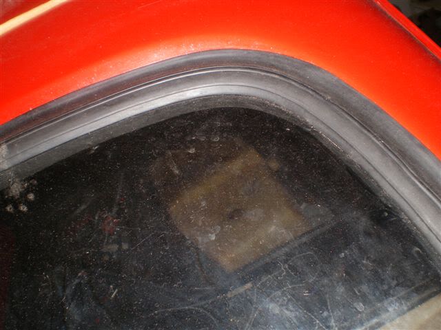

Here are photos of the imported rubbers, as can be seen, did bring in the full set, and very happy that I did........
Did you notice that the beading has been left out
, and that I have fitted a 4 mm "O" ring rubber into the slot
to lock in the rubber, and this took time but I like it like that......
More photos to follow....

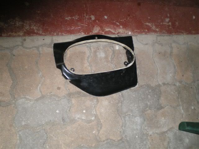

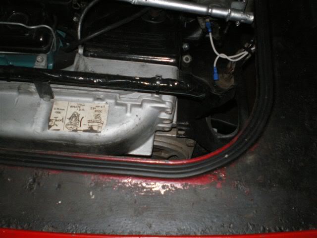

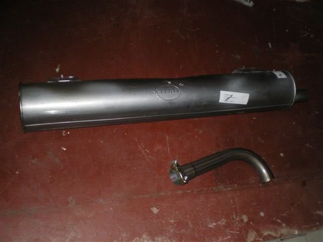

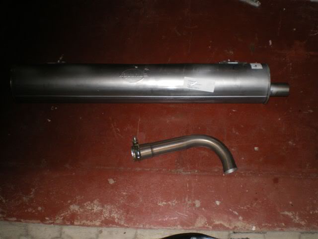

Received my new Stainless steel type 4 Tuffy exhaust today, Looks goooooood...
Now I will be able to tune the car to its correct values..
and modified the "IMPI" shroud ( sorry Armand) to close out the suction from the Alto side with a web.
This will close off most of the area under the shroud, where the belt is running, so preventing hot air from getting in....
Waiting for more toys to arrive...........
Someone promised me a type 3 dipstick and lock top as mine is gone, but need to go back in my posts who it was
