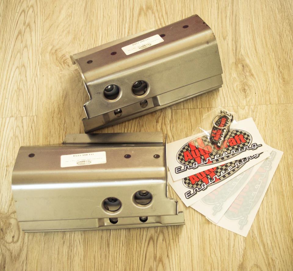

I have managed to get a few more bits

Hey ! That looks Nice....
As long as it keeps moving, some times slow, sometimes fast, but it will get there in the end.....
Keep up the good work.

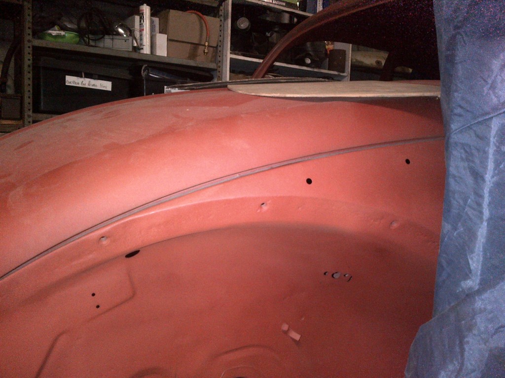

Is this a normal size gap between the bonnet and the body ? I cant remember this gap being so big.

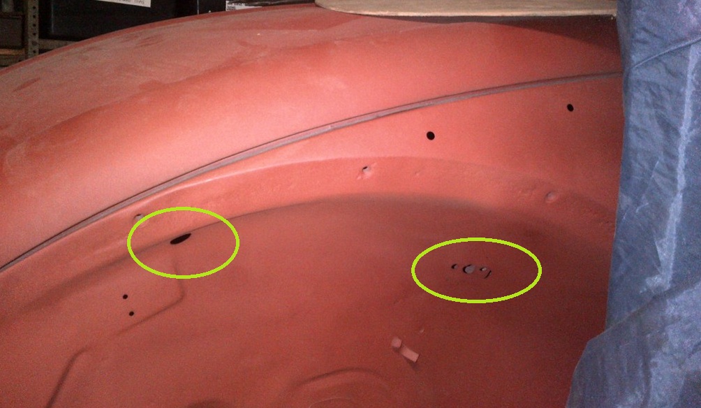

Donovan, I am sure you can get it better with final adjustment.
Make sure before you paint if the big hole in the quater pannel should be there, the one near where the fuse box mount.
- Posts: 8710
- Been thanked: 541 times
That should be for the speedo tube.

Which hole are you referring to ? I think the three hole one is the one for the speedo, the bigger one I have no clue. Whats the two smaller holes for ?

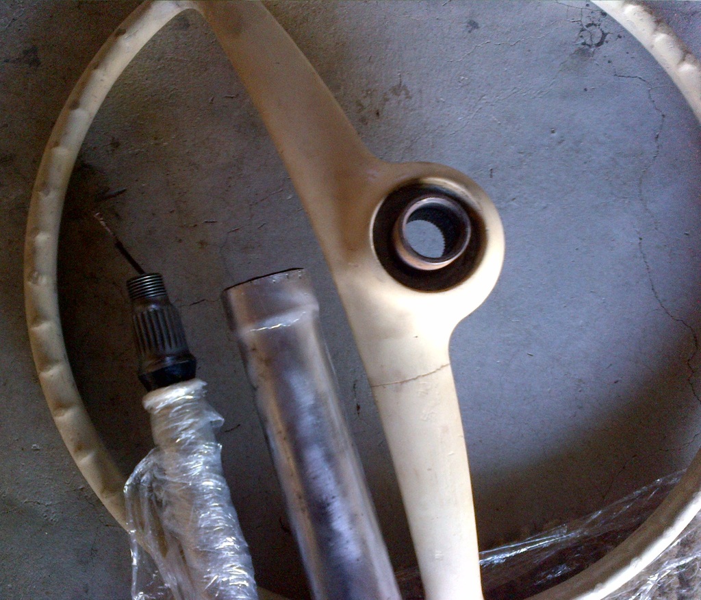

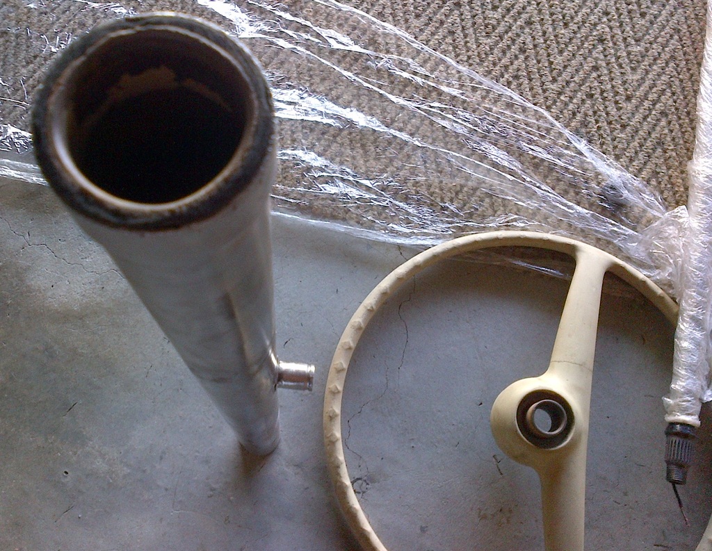

Am I missing something between the steering wheel and the shaft ? If I push the steering shaft through the outer tube and attach the steering Im unable to turn the wheel.
The steering shaft itself is also bent, Im guessing this should be straight but its bent in such a way that I'm second guessing it.

I was referring to the big hole in front. Yes, the rear one is for the speedo tube. Think the big one in front was drilled for the indicator wiring when indicators was fitted on the fenders at some stage. The two small ones in front is for the fuse box.
