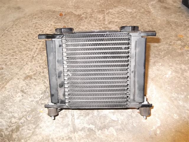

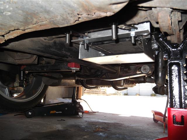

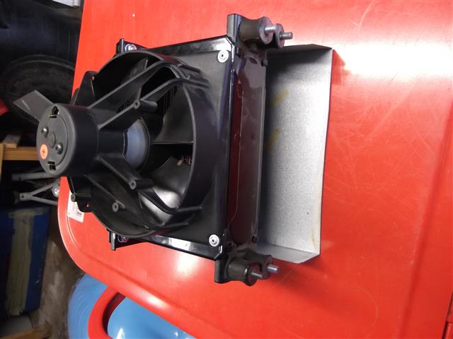

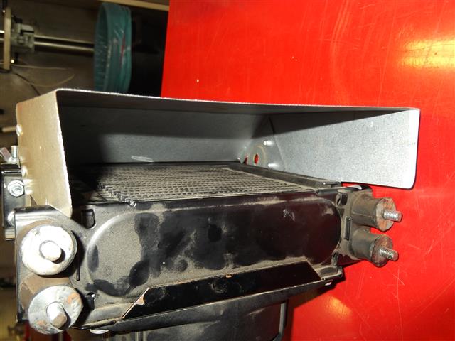

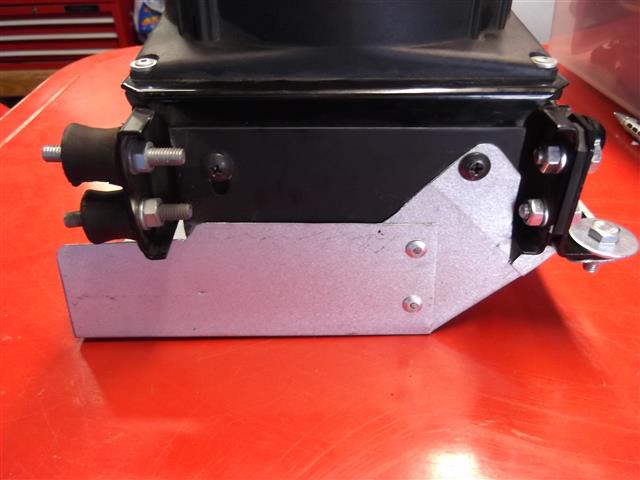

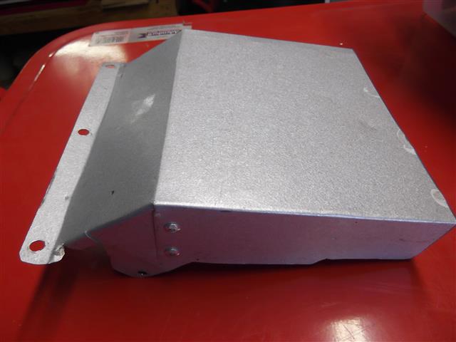

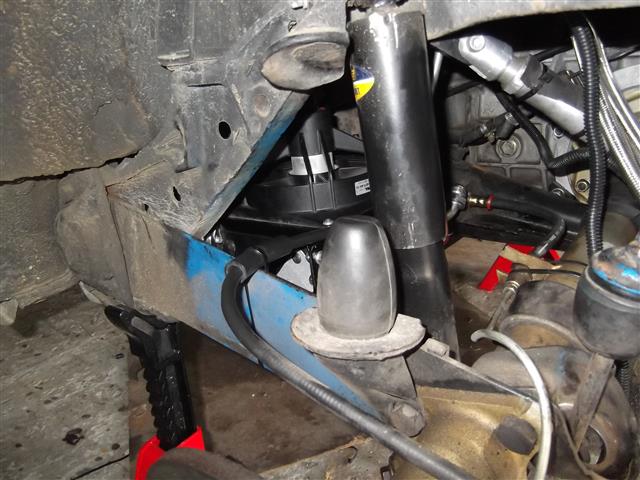

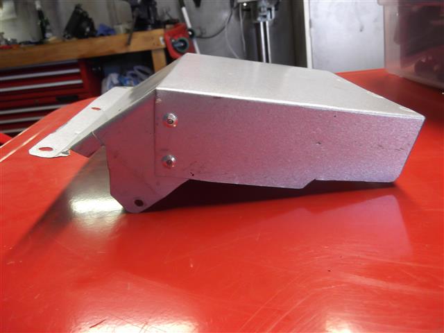

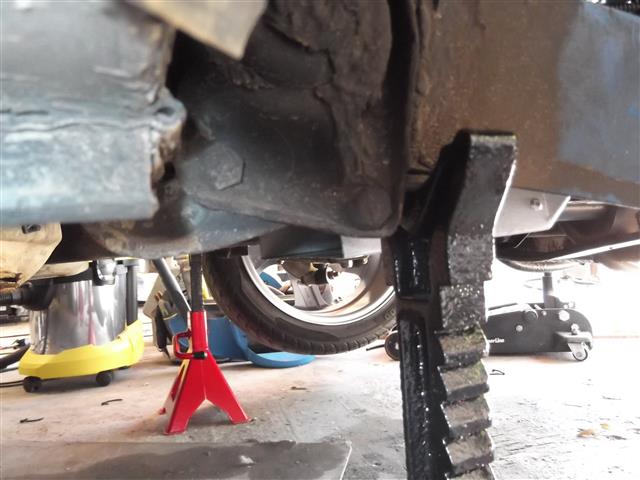

OK, time for a bit of an update...
Going through my camera, it seems I should take more photos... but anyway, here is some progress so far.
For the first time in years, I have returned home from work and have a beetle that I can start up and drive without needing to tinker. So what do I do?
I start her up, drive her into the driveway, clean the garage, drive her back in and start taking things apart.
I wont go into details of all the thoughts that have gone through my mind, ranging from redoing the interior to a full respray, but instead I settled on a bit less work.
I began with wanting to change an oil hose from my filter to my thermostat. This hose turned through a really tight radius and I cant help but worry that it might collapse and cause a blockage and loss of oil pressure/flow.
Then I decided to pull out my oil pump and blueprint it and also ensure the pump cover was perfectly flat.
After that I decided to neaten up some wiring around my oil cooler and while doing this I decided to neaten up the wiring inside the car, at the rear, for the engine management system, the oil cooler fan, remote starter switch and the fuel pump. I also have a few other wires supplying power to a fuse block in the front for items such as my radio, gauges, fuel pump, hooter and so on... So to do this, I removed all the seats and began rewiring.
While doing this, I took another look at my oil cooler and decided to move it. So a new location was spotted, and a method of mounting the cooler without welding was devised. From here a scoop was made, fitted and everything mounted.
I am still busy with this project/exercise, but decided to put up some pics of my oil cooler and scoop. Its not the greatest and I would have liked to have soldering iron large enough that I could use to solder all the joints, but 4 rivets and a few machine screws suffice quite nicely. Either which way, I am still fairly chuffed with my progress.
Not the lowest point of the car

- Posts: 7948
- Location: Johannesbirg
- Has thanked: 18 times
- Been thanked: 58 times
We are buzy with a 2020type1 for Emran and did the same type of scoop on the oil cooler and at the same place
On my Rotary Double cab bus I have done a similair scoop on my oil cooler oil temp came down around 35Deg and water temp around 8 deg so I was very impressed with the scoop mod
Keep the Updates comming
