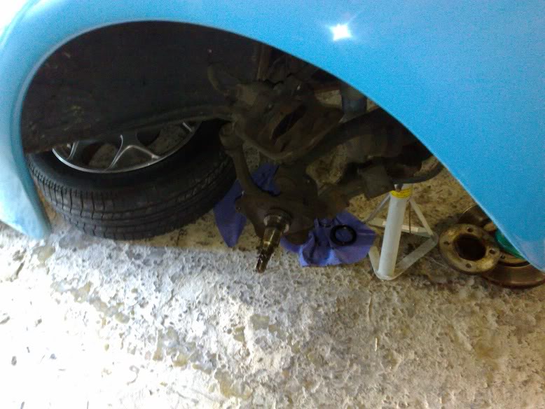

Last week I bought new mags....
These have a different PCD as stock, so I am busy getting the hubs and discs redrilled.
